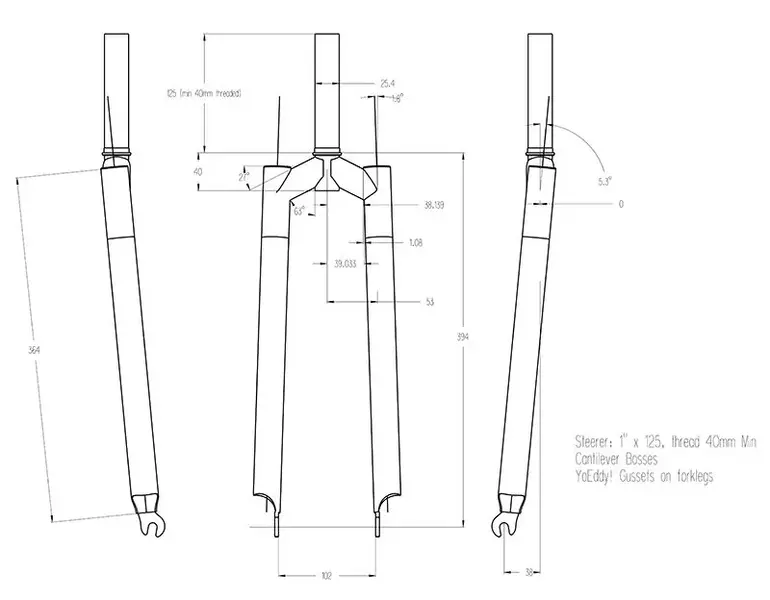

Afternoon peeps. I’m on the hunt for the spec of the above fork so my frame builder can weld a set up. I have a 1996 Yo Eddy, which I believe is corrected for a 65mm 1 1/8th suspension fork. The new BOI fork needs an axle to crown measurement of 440mm (I think) and a measurement for rake, this is where you guys might help me. Just one further question, are there any other measurements I might need, as this is all new to me. Thanks in anticipation, Pete.

The A-C varied as the years went on iirc. 92 and earlier were typically non sus corrected A-C 390-5mm, 93-96 or so A-C of 415-425 and from 97 ~ onwards A-C went from 425-440mm depending on the model. You can tinker with the A-C by adding a CK 10mm baseplate extender. I have one if needed. Comparison of the head tube length for the same sized frame in different era catalogues ( found on here in the archives ) will confirm the above. The shorter the relative headtube, the higher the A-C needs to be.

Hey fellow Retro Bikers, I’m ready to ask Lee Cooper to make my BOI fork. Just to confirm, my Yo Eddy frame is an early 1998, which I believe is suspension corrected for a 65mm fork (?, sadly, I don’t have access to a 1998 catalogue). I now have the correct canti bosses (thanks Danson), the correct Campagnolo dropouts (thanks Lee) and the correct fork rake at 1.5 inch.
Now for the A - C of the new fork. Like I’ve said the serial number dates it as an early 1998 Yo Eddy Team frame. The frame’s head tube is 121mm (now powder coated). Remembering M-Power’s excellent post (thanks), what length A - C should I ask Lee to build? Should it be 425mm or longer say a length between 425-440mm or 440mm? All/any help gratefully received. Peace and love, H.
