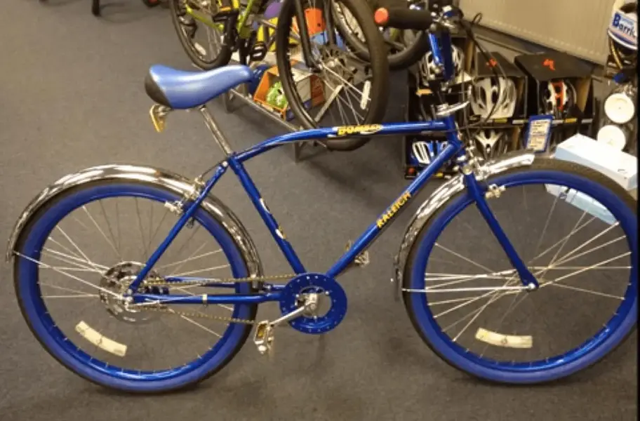

And here's your bmx inspired 26er, the Raleigh Bomber...
And what an utter shit show of a bicycle they were too
And if some sort of easily accessible electronic pictorial communication's existed in the 1970s, things may have been different, but they weren't and bmx inspired beaxh cruisers, cruisers, came about instead and that was as far as you could go if your aim is to build a bicycle for all terrain based on the idea of a bmx

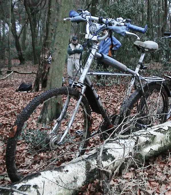

Someone in the 1970s UK had been thinking about off roading and traversing all of the muddy terrain so they built their own 'atb'. Fabricating their own bits and utilising bmx and other bits...
Cleland! 😋
Sooo, your bmx inspired atb
21.1mm stems, bmx bars, one piece cranksets
Bmx tubing? Are you sure? Designed specifically for small frames, not really suitable for the larger wheel size if going off road, bearings, headsets and seatposts
Gears: hub or derailleur? You're going to have to borrow from somewhere, there's only 2 and 3 pd hubs available, 4spd being too fernicketty
Hub or cantilever brakes? Hubs overheat and there's not much choice for decent rims
I think if you look at what was about in the 1970s, you'd end up with something very similar to what came about due to the impracticaliies of the parts bin of the day
Or, do a John Finlay Scott and build an 'mtb' in the 1950s when there were no bmx to look at
No, that's just a shit bike. An example of Raleigh's attempt at making a certain shape of bike.
Cruiser shaped.
There were proper race ready 26er BMX cruisers long before that poor excuse for a bike appeared.
Cruiser shaped.
But it's what you asked for! Bmx inspired off roader! Just because it was the Talbot Rancho of the day 😂😂😂
