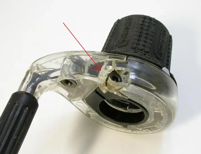

SRT - 800's were very brittle (prone to cracking around the clamp, and should always be mounted with a slight gap between them and the brake levers for the same reason.)

Completely agree. I have a set of X-800 (Clear X-Rays) that came with my 1995 Kona Explosif. That bike only had 200 miles when I parted it out. Both shifters had cracks on the plastic around the clamp. Still work, but rather disappointed about that. They also require a decent amount of force to shift, which I'm sure doesn't help the cracked clamping mechanism.
I also have the ESP 900 and they are smoother shifting, more comfortable grip and they don't crack. I also have some of the 7sp shifters and they have really lasted, but the rubber turns sticky over age.
Here's a pic of one my X800 clear shifters showing where they crack.
