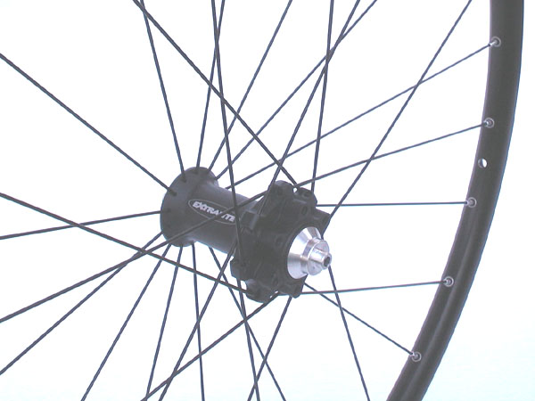

Here is a picture of the hub..

He's talking crap. He probably just couldn't find the specifications for that hub (flange diameter etc) so he knows what spoke lengths to order. Usually on a rear hub the drive side has shorter spokes than the non drive side due to the dish. I can't seem to find the specs for that hub though so you know what lengths to order.

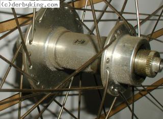

It's impossible to build a hub with one flange higher than the other....
...wait a minute:
If you have a set of vernier calipers, a ruler and a spoke calculator like DTs online one then you'll be fine. Never gone wrong yet. The best idea is to take it to another wheel builder who knows what the hell he's doing!
Totally agree with Pete's comment, I have built 100's of wheels over the last 20 years, only a case of measuring the hub and using a spoke length calc.
To me looks like the standard "generic" DRM revolver sizing
2.4 57.0 31.0 45.0 20.0
Give that a go...
