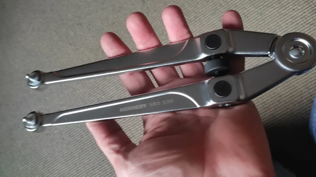

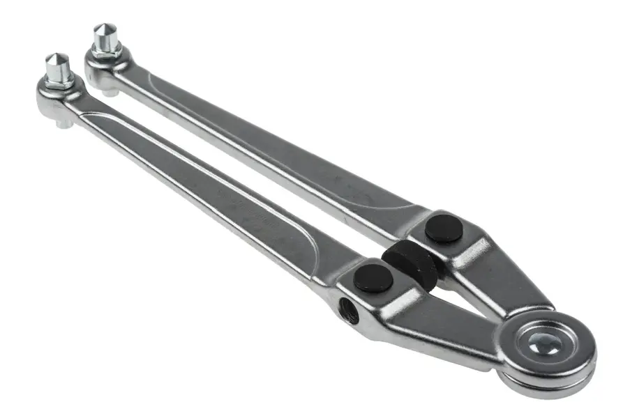

One of these. Adjustable locking pin spanner:
I have one, coming for a different workshop job, which you can borrow.
All the best,
I had one of those, bought in error years ago but can't find it for love nor money. I can confirm my circlip pliers don't have the reach and I suspect strength to budge it.
