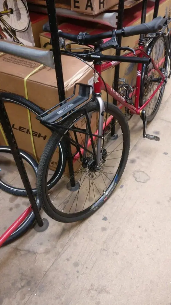

I have replaced this as my hardtail, and I'm thrilled with my new 29er, but I don't want to part with the Wanga, so I've begun converting it for bike packing / touring. I've fitted some basic double-walled disk wheels with 700x35c tyres, a rigid fork and some basic tektro brakes. Next I'm going to get my swept bars back from my old man, along with my ergo lock on grips. I'm also going to cut down the lower set of bars as these are just for accessories like handlebar bag and lights. I've ordered an 11-36t cassette and some 160mm disk rotors and it should be up and running.
Before anyone says anything, the fork isn't on backwards, it's just a quirky design that has the brake caliper on the front right of the fork rather than the standard position.

Bike packing is fun and I used my 1990 Muddyfox prestige comp last time I did it. The next time will be my Raleigh 531 Team.
As for the fork I hope it's an IS mount caliper and bracket as if its post mount the reason they are on the back as you can quite easily tear the bolts out of the threads as the bolts are not designed to work that way. The usual braking force pushes the caliper towards the solid part of the fork so the bolts only hold the caliper in position, this way around those little M6 bolt threads are taking the load of bike, rider and luggage in spikes too. Post mount might lessen this but if a converter is used it will be the same net result.
Carl.
I've been bike packing on my old Kona hahanna on 26" wheels and had a great time. I've now given that to my dad who needed a new commuting bike, so I've chosen the voodoo frankenbike as a replacement.
That's a good point you've made about that fork, and I hadn't thought of the implications. I just accepted that it was designed that way and was going to run an IS to Post mount adaptor, but that will result in the bolts in a pulling situation. I might have to keep an eye out for a different fork then, for peace of mind.
Partly due to the quirkyness of the fork I had fitted, and partly because I decided I wanted to accommodate a front rack, I picked up a genesis croix de fer fork on here, and am in the process of fettling that so that I can squeeze an SKS mudguard between the fork and 35c tyre where there is only a bawhair of space.

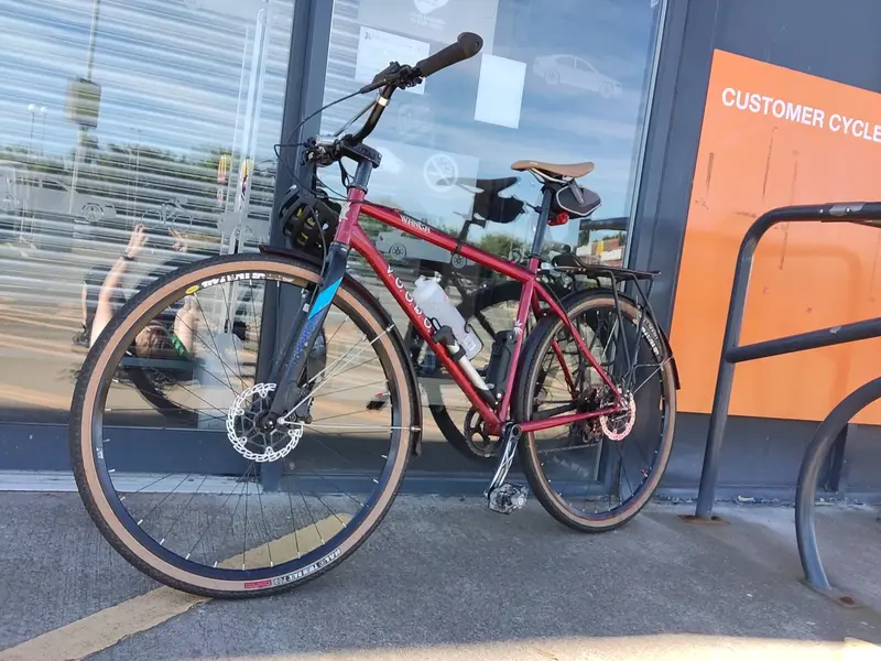

Just realised I haven't updated this in forever. I've changed the fork to have clearance for a mudguard and acquired a ritchey kyote comp handlebar for mucho backsweep and a little rise.
