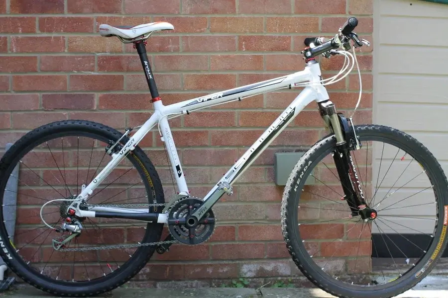

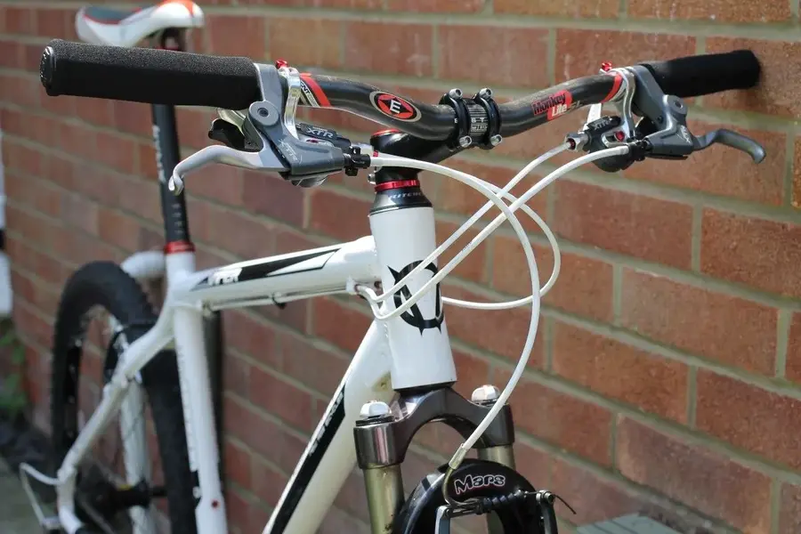

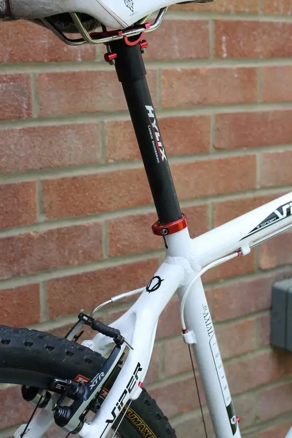

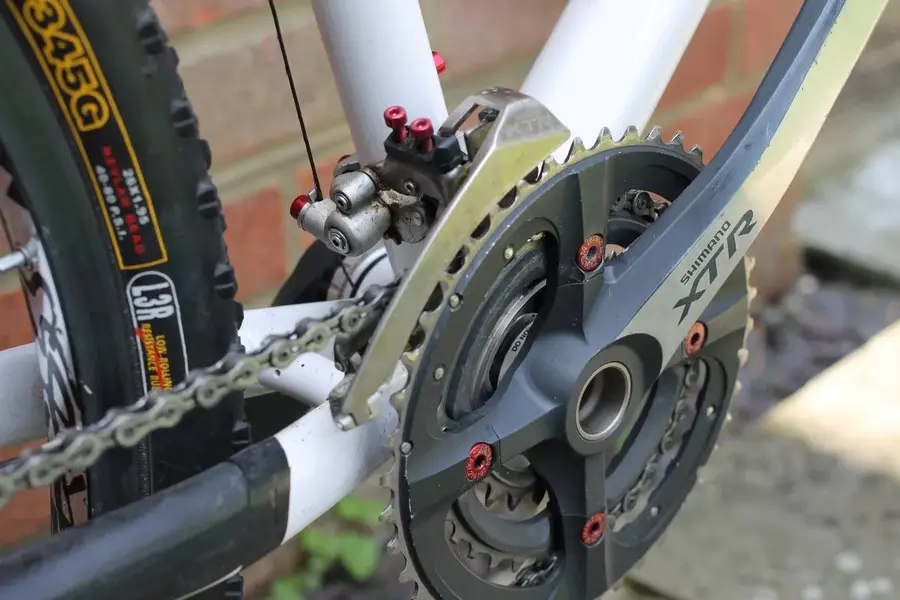

Re: Viper Scandium 19lb Weight Weenie build
And here are the final photos. Just the saddle to replace when I find a Charge Knire...
