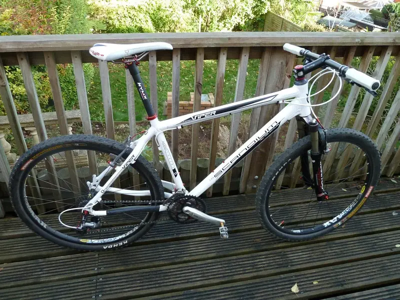

Another little update after a few tweaks. The Avid Mags are light but I got the idea of tuning them a little. I added red tension adjuster bolts as pictured for about 75p each (M3 x 35mm, so I had to cut them down) - just for effect, but probably saves 2g off the overall weight. I'm also replacing the pad carrier bolts and nuts with Ti ones - not sure how many grams will be saved (10-15?) but they were £10 for the set.
The rest had a bit of a white makeover - my WTB Shadow SLT matches the build nicely and I had a lighteight set of white grips very much like the Ritchey WCS ones, only about 5g lighter. And off come the bar ends, since I haven't used them for ages. I haven't put the American Classic/X517 wheelset on yet as I'm waiting for some strapping tape to arrive for the rims, since that's supposed to be good and works out about 7-8g per wheel.
Haven't yet calculated the new weight but it'll be under 19lb complete (inc. pedals).

Well it's been a while since I've updated this build. However, after some soul-searching I've taken the plunge and gone and bought some disc wheels. Couldn't really resist the chance to put onto this...
file.php
...a set of these:
The result should look pretty sweet I think. Next to start thinking about weight weenie options for discs and brakes (my first discs, so I need to learn fast). Possibly some tubeless tyres too... Maybe it's time I stopped obsessing about the weight since I've got a road bike that scratches that itch now :)
Just realised there have been some other updates on the bike since my last photo too, M970 shifters & M952 brake levers, a beautiful Dura Ace long cage rear mech with a full red ano blinging, White WTB Rocket Ti saddle.
