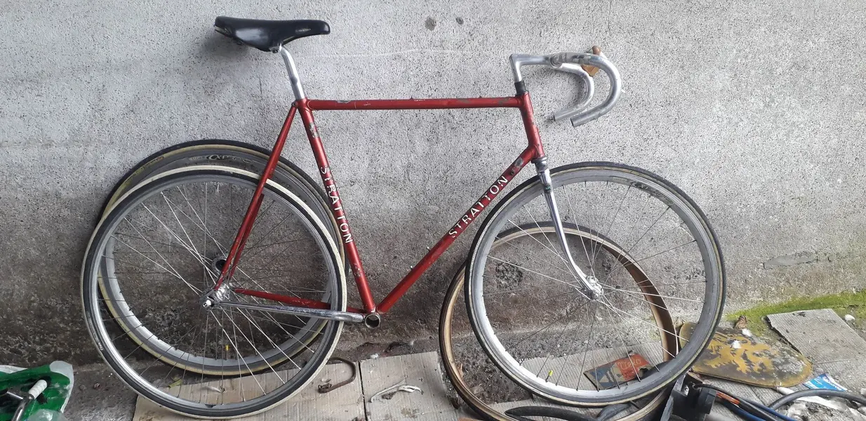

This is my other frame, subject of this thread
https://www.retrobike.co.uk/threads/80s-stratton-roberts-frame.436345/page-2#post-3193942
It's actually a 59 ctt. I measured my inseam and multiplied by 1.09 to get saddle to pedal length of 97cm, checked my gate and I already had it exactly on 97. My Roberts would look like this set up the same, but with alittle longer reach. The campag post is up nearly to the max. Stem is 110 DA and old giro d'Italia bars. Repairs and respray is going to likely cost more than simply getting another similar frame slightly larger and not in need of restoration. I guess the obvious answer is to build it back up again and ride it some more...
Any thoughts anyone? I guess I could make it fit better with a different stem.
