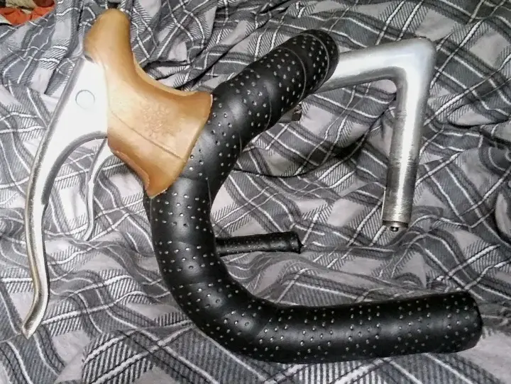

I'm going to say the drop on those bars could well be the issue.

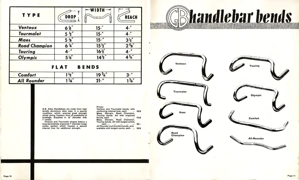

I use GB Tourmalet which have exactly the same dimensions as the stock bars on a 1982 Holdsworth Avanti.

GB 60s catalogue

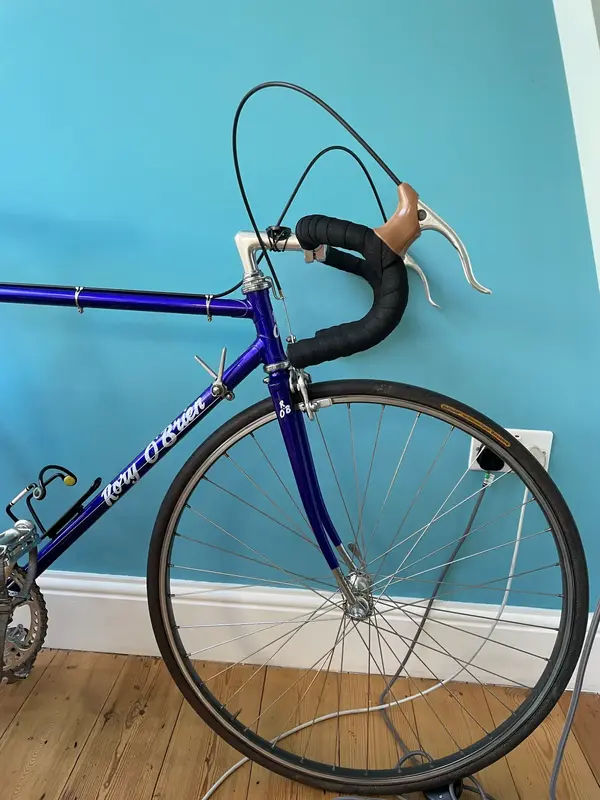

Installed (I mostly ride on the hoods):

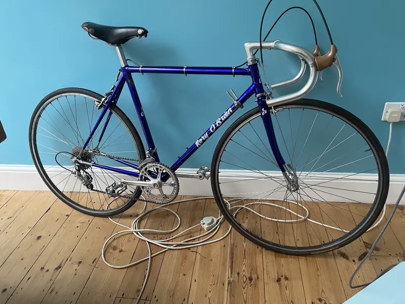

Those bars you have on the Rory O'Brien look to be deep like a Cinelli 66 . A Cinelli 64 is shallower so when on the drops you will not be as far away from the brake levers . For a classic look a slight slope to the rear about five degrees from horizontal when setting the position of the handlebars in the stem . Cinelli and 3ttt do stems/bars in 26 .00mm and 26.4mm diameters . The esteemed Japanese maker Nitto I think do 25.4mm and 26.00mm diameter . You need to make sure the sizes of your bar and stem are compatible ie 26.00mm bars with 26.00mm stem . These are classic retro sizes , modern bikes have oversized bars and stem . A one or two foot straight edge/ spirit level placed underneath the drops will allow you measure from the straight edge to the bottom tip of the lever to make them level . It is trial and error but you will find a happy middle ground.
