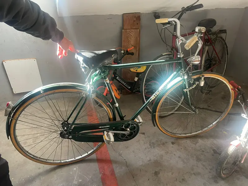

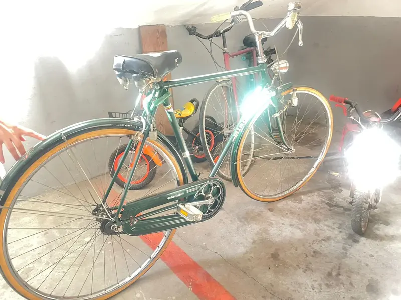

Hello everyone,
I’m looking for help identifying my vintage Bianchi bicycle. I believe it could be a Bianchi Selvino, possibly from the early 1950s. I’m based in Morocco and recently acquired the bike, which appears to be mostly original.
Here are some details:
Color: Dark green (not the usual Bianchi celeste)
Frame size: Approximately 56 cm
Shifters: Downtube friction shifters
Rear hub: Marked “FB 51”
Internal routing for rear brake and gear cables
Integrated headset on the head tube
Dynamo-powered lights
Saddle: Mondial (looks original)
Tires: 32-622
I’ve attached photos for reference. I’m especially interested in knowing:
The exact year or range of years it might have been made
Whether this really is a Selvino model
Any insights on the originality of the parts
Recommendations for restoration (tires, lights, etc.)
Thanks in advance for any help!

Hello Mehdibike and thank you for sharing this machine with the forum.
frame -
constructed with Agrati bulge-formed head of "EXPORT" pattern
Agrati "AMERICA" pattern seat lug N. 086.8569
Agrati bottom bracket shell, likely model N. 022.8507
Agrati dropouts N. 000.8002
Agrati fork crown N. 000.8528
Agrati fork crown cap N. 202.9110
Agrati fork ends N. 000.8010
Agrati plate style bridges & pump pegs
fittings -
headset appears OFMEGA
chainset either Way-Assauto or OMG
pedals either Agrati, Way-Assauto or Sheffield
you may be able to read a marking on the endcap
"FB" hub stands for Fratelli Brivio
welded stem/bar set may be Varese or Schierano
chainguard case and mudguards are from the firm of Mazzucchelli
center disc of chaincase has gone missing

wheel rims may be Maccari; there are six or eight other possibles...
dating -

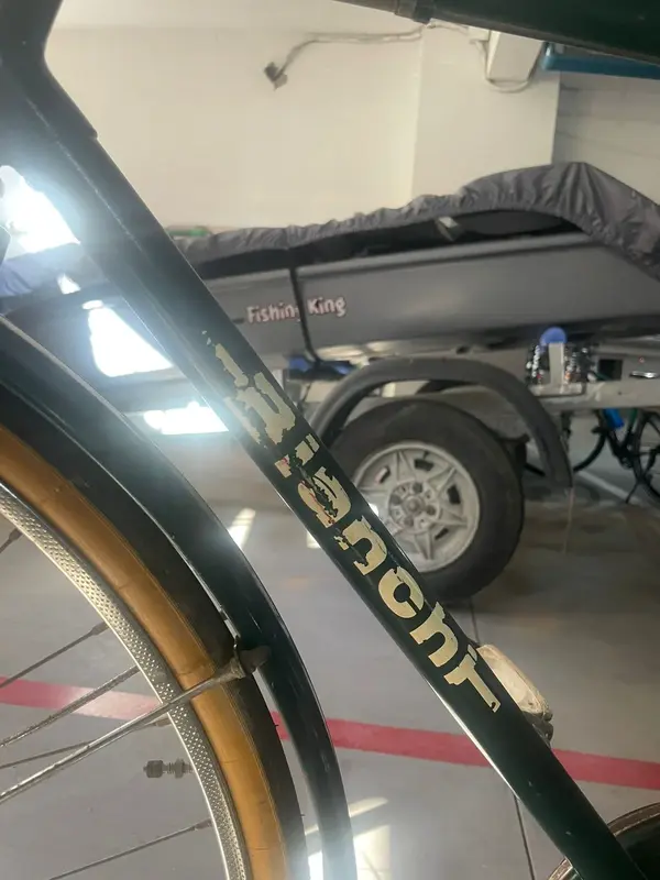

transfer set worn by frame noticeably later than "1950's"
estimate date as somewhere betwixt late 1960's and early 1970's
other readers may be able to give a more exact date...
Welcome, @Mehdibike . Nice bike in a classy colour!
But unless the Bianchi direttore was clairvoyant this machine is no older than 1975, given the championship decal.
The downtube decal is in a style that was solely used in the seventies, AFIK, so I'd say your bike is from the latter half of said decade.

Thank you so much for this detailed breakdown!
I really appreciate the time and knowledge you put into identifying all these components it helps me understand the bike’s history and construction much better.
The information about the Agrati parts and the estimated dating is especially valuable to me.
Thanks again for sharing your expertise!
I hadn’t seen this model on Bianchis from the 70s, which is why I initially thought it might be from the 50s — possibly a Selvino
