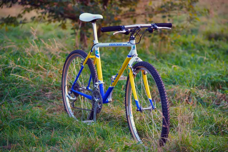

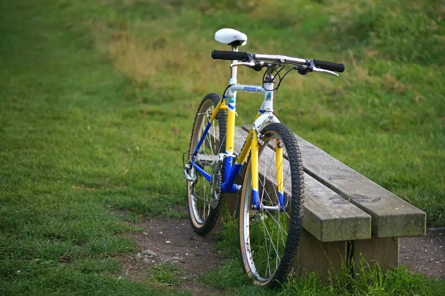

I think it looks great mate!
Maybe a little trimming needed on the brake cables? Hard to tell though, the portrait mode photos are actually almost a little distracting! I know it's supposed to highlight things, but I keep getting drawn to the weird little glitches it causes in the out of focus of stuff instead. But in that second photo, the totally normal old school one, there's nothing I think I'd change!

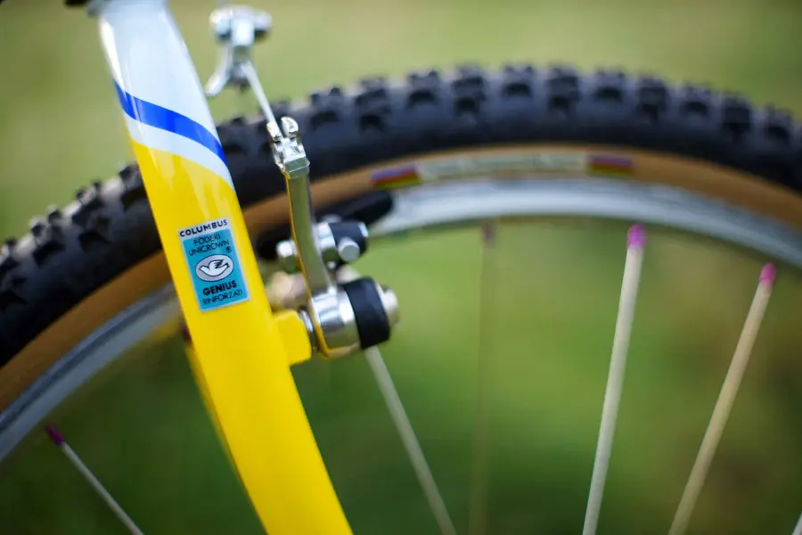

I’ll need to lower the canti hangers and set the brakes up so they’ll stop the bike! Hehe
The suntour blocks are nos and seem to have the gripping power of a steam iron.
May need to change them - I was thinking Red kool stops
Before you go changing things AGAIN, try rubbing the braking surface of the brake block with some medium sandpaper this removes the shiny surface and helps them grip.
Ok that sounds rational - unlike my knee jerks

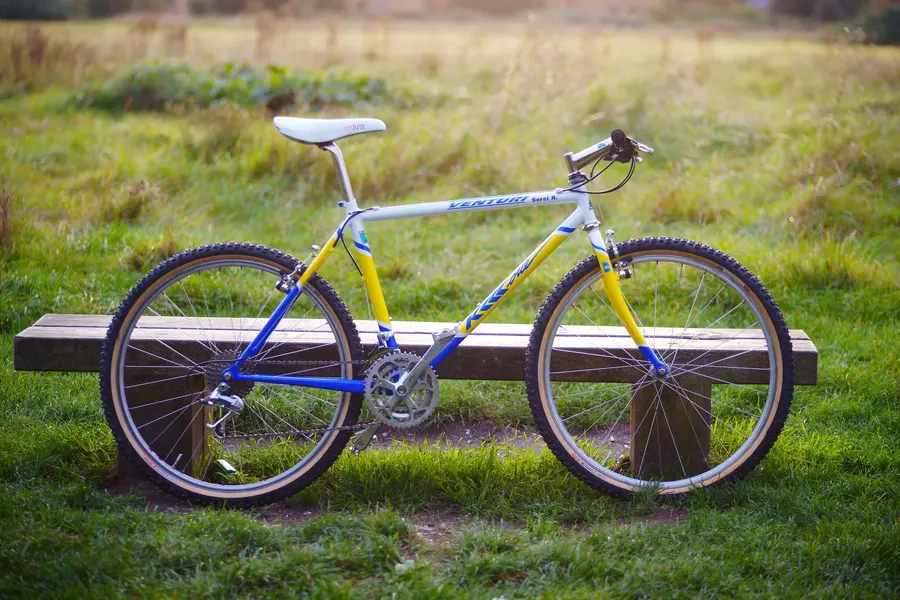

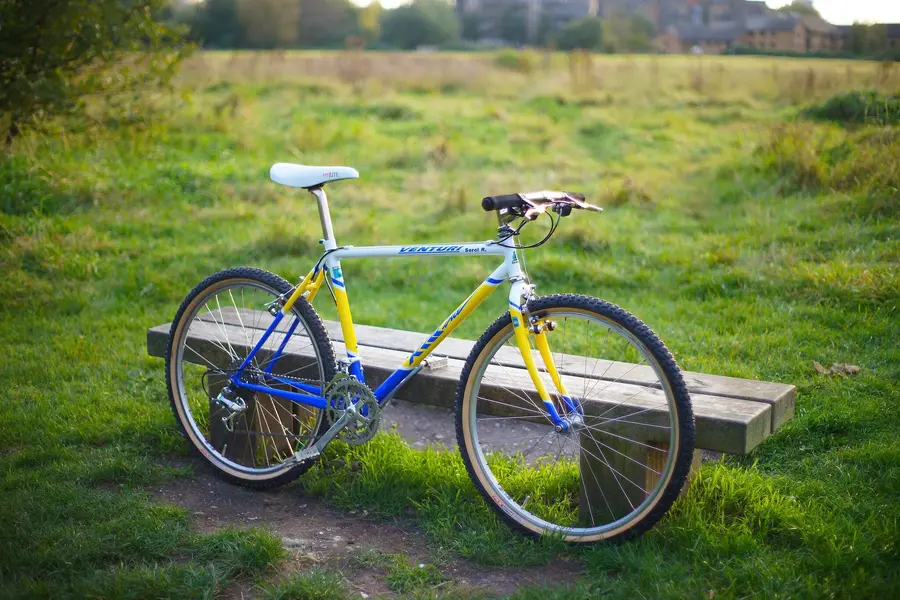

Finished!
And I love it - man, it feels so sorted, such a joy to ride - swift, beautiful frame - which feels brilliant and very light - weighs less than my Bianchi Martini Ti (and that's 20lb dot on) soaks up everything and just shears through ....
