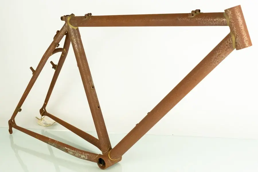

Yeah that's the same seller, same frame. Generally accurate description, the part about the "fork tube" is not well put -- there's no fork, and the head tube is actually quite short at ~85mm, which is a good thing, it's gonna be hard to find a fork that won't work, which I think is the point he is trying to make. Frame arrived in good condition, there's a bit of surface rust but it was clearly stored properly
Headtube 85x30mm
Seat tube 27.2
Spacing 135
Chainstay 419mm
Seat tube (center-top) 17 1/2 inches
No fork
Mostly shiny, a bit of surface corrosion especially around the cable guides.
I don't have a scale but it feels SUPER light
BB is 68mm, interestingly
Looks like they used silver solder, not brass.
Nice frame...
Italian threads on the BB? Get that threadlock at the ready!
This frame would look awesome in lacquered bare metal, wouldn't it. I just might need to make that happen
