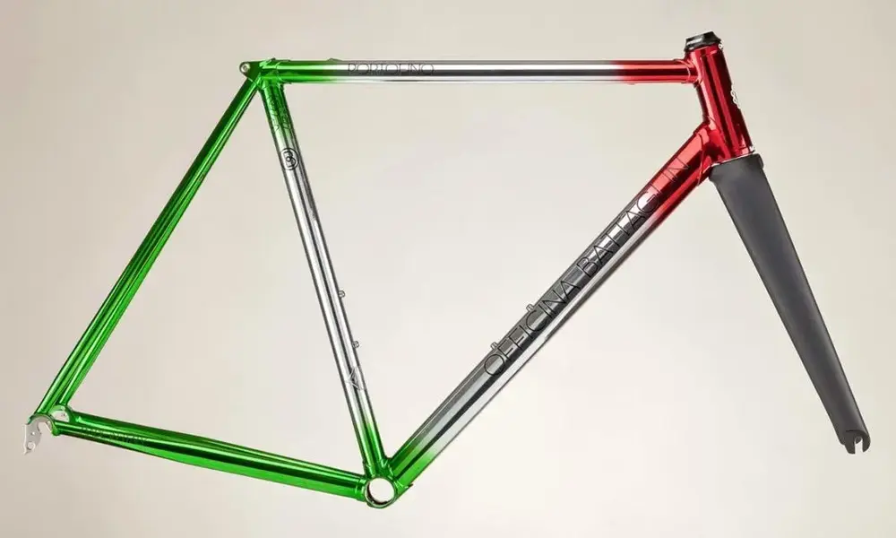

And then there's this. This would not be all that difficult to do with powdercoat.
Makes the rest of the build easy. Shinier the better, I figure
That looks sweet!
I presume the paint is translucent allowing the brazing to be seen??
Either way. The red and green would be translucent top coats, just depends on whether I do a chrome base layer or just polish up the steel.
Problem with clear coat is, it may not start out as a ratbike but it'll become one quickly (and we live on the bay, so, very quickly)
In my mind, this can take off in one of three directions --
1. Annoying mini-doppleganger to the Mone La Roca. Bronze or root beer translucent topcoat with gunmetal-blue bits. I have some more or less period correct bontrager components I could use in that build, for at least one photo-op, although it'll very quickly grow some Renthal MX bars and EndlessBike singlespeed bits. Maybe (nay, certainly) slap some Barnacle forks on there. Heh! Sporting the biggest, nastiest Maxxis DHF I can cram in between em, and probably a disc brake to boot. Post that sucka up on /xbiking and call it a day
2. Source some FRM parts and make it pretty and possibly a worthwhile resto on some level. Post it up here and then be scared to ride it basically LOL. Tricolore color scheme but probably with a white base
3. I have a mid-level Shimano groupset on hand that's right-on-it period correct, I could polish that up and bling out the paint job. Good for riding down the bike path with the "ducati pout." Nice bike! Yes, I know. Chrome tricolore all the way; I want it to blind ya when the sun comes out. (My Harley is like that; there's no such thing as too much chrome IMO)

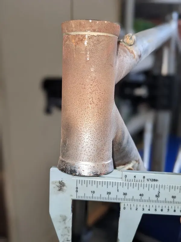

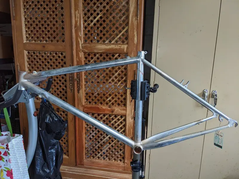

Frame is here, am headed out to look at it. Won't be able to mess with it for a couple of weeks due to work sched so if anybody has any questions or needs measurements or stuff let me know
Headtube 85x30mm
Seat tube 27.2
Spacing 135
Chainstay 419mm
Seat tube (center-top) 17 1/2 inches
No fork

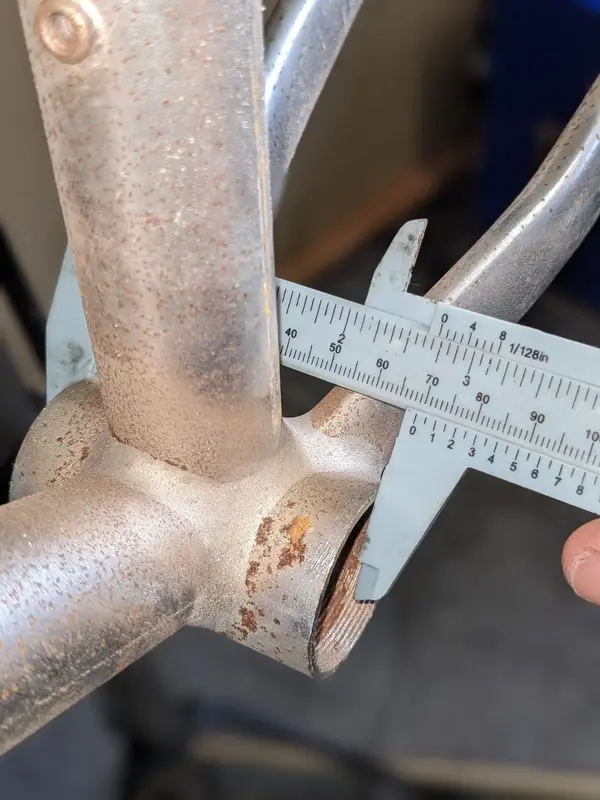

Mostly shiny, a bit of surface corrosion especially around the cable guides.
I don't have a scale but it feels SUPER light
BB is 68mm, interestingly
Looks like they used silver solder, not brass.

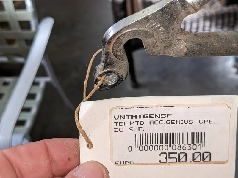

More pics. Seller is out till end of jan
