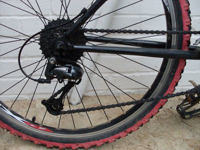

The call came yesterday afternoon to say that my retrobike was repaired... :D

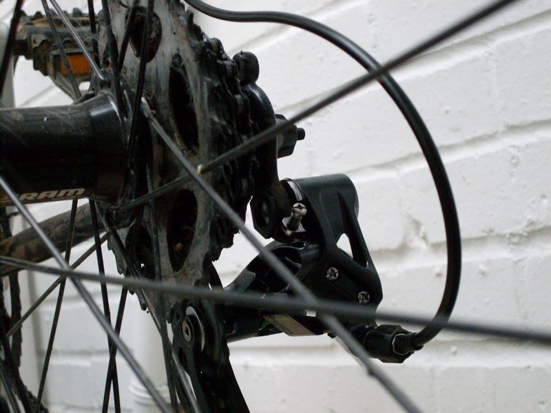

The hanger has been bent back into shape, but not without distorting its internal screw thread. So that's been drilled out, and a sleeve has been fitted with a hexagonal collar. And the new rear mech has been bolted into the sleeve...
On that second shot, you can see the silver-coloured spacer is still between the spokes and the cassette. The guy at my LBS didn't think that the 7-speed cassette on the 8/9-speed freehub was the cause of the damage -- but I still haven't ruled out upgrading to a cassette that doesn't require a spacer.
Glad you are back in the saddle, but I'd say time to find a better LBS, or my preferred route: sort it out yourself!
Like a lot of the posters in this thread I have straightened rear mech hangers without 'proper' tools and never shagged up the threads... Or needed heat, just a bit of muscle! Good old adjustable wrench technique
Use of the proper tool or Steveo's rear axle suggestion would have prevented distortion of those threads, as the hole and thread are occupied by a bar of the correct diameter and thread which is what you use for leverage, the proper tool also allows the bonus of alignment checking
Of course you'll have no issues the remedy you have got there is perfectly serviceable, just appears they created another issue by poor technique/tool selection
