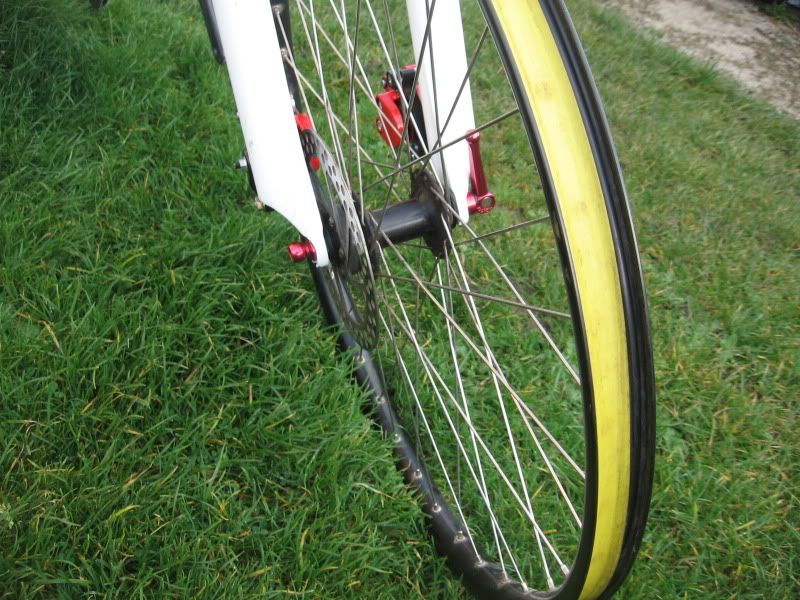

some mock-up teasers.......
looks cool so far :D

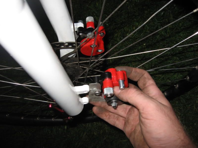

started the first +20mm mount today , got as far as the 2 plates so i'll weld them tomorow :D

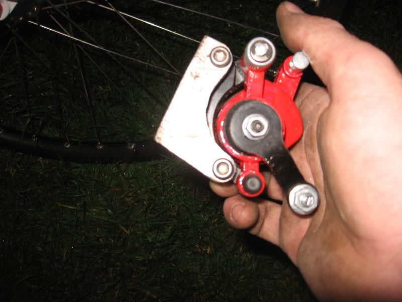

the plan is to fit the 180mm disc to the hub and hold the caliper in it's position then tack it .....
some pic's......
when it's done i'll flip the wheel round and do the other side....... then it's just a case of tidying them up and paint :D :D :D
