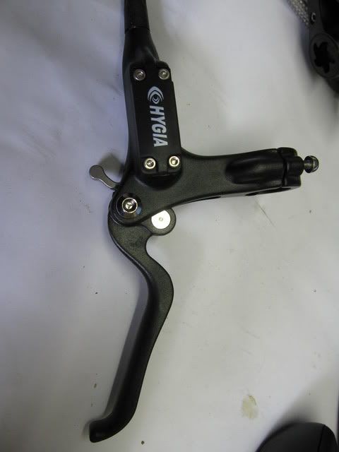

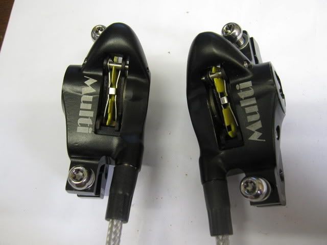

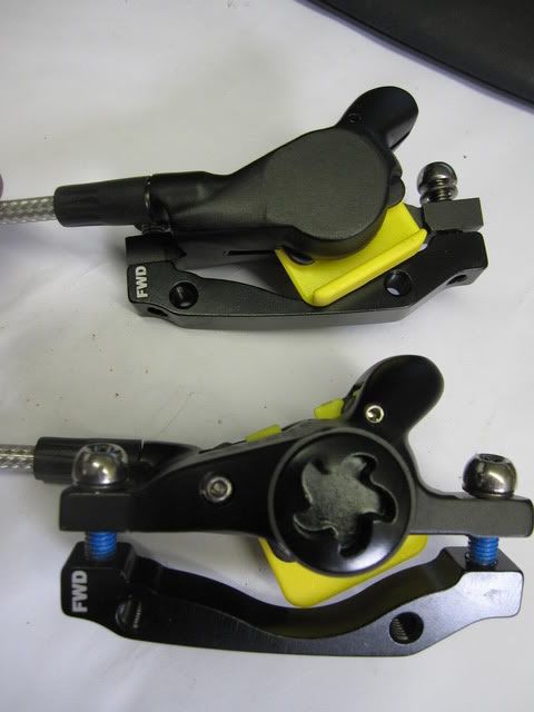

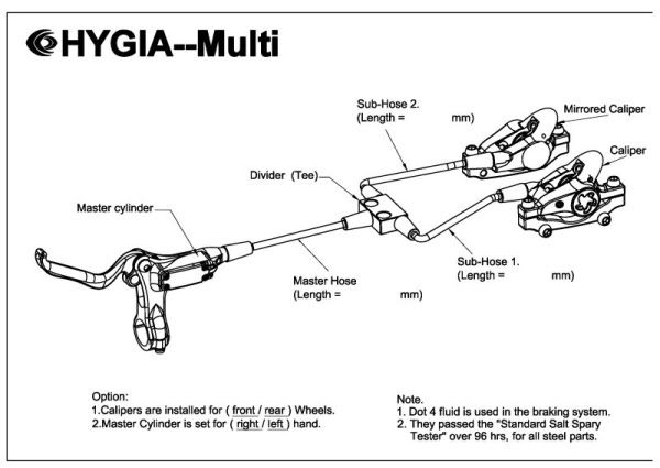

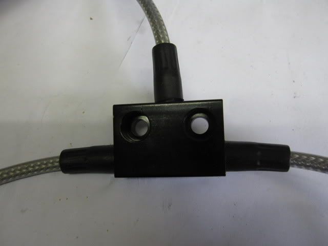

Would you guys be interested in this?
I got a set direct from Hygia (www.hygia.com/tw) a few months ago for a trike project at work. $90 USD + $30 handling + $55 freight.
It's a pretty good looking brake, ISO adapters to post mount, cast alu mirror image calipers, 22mm single pot. There's a pretty basic splitter, looks to me like they're running smaller slave cylinders to get the travel. The little lever sticking out is a parking brake (optional)
I've not got around to building the proto trike yet, so I can't comment on the performance. Here's some pics:
I do have the RH lever :), as I got a complete set...ie there's a single caliper brake too.
I needed a single rear fitting (for the front wheel) and a double rear fitting (for the rear wheels) with L and R levers on a front wheel drive delta trike :?
The ISO adapters are all 160mm rear postmount, but Hope or Avid adapters would convert to front fitting.
They're not for sale as such, I'm not going to be getting around to using them for a few months, probably...
If you'd like to borrow them for a trial and swap the levers over. They're going on a factory prototype eventually, so a few scuffs won't matter.
The hose fittings all look pretty standard. I think they run on DOT fluid not mineral oil, but I'll have to check.
They're set up with really long braided hoses, so I'd have to cut them down anyway.
If it all works, I can get another from Hygia easy enough. If anyone else is interested, I could get a batch in.
