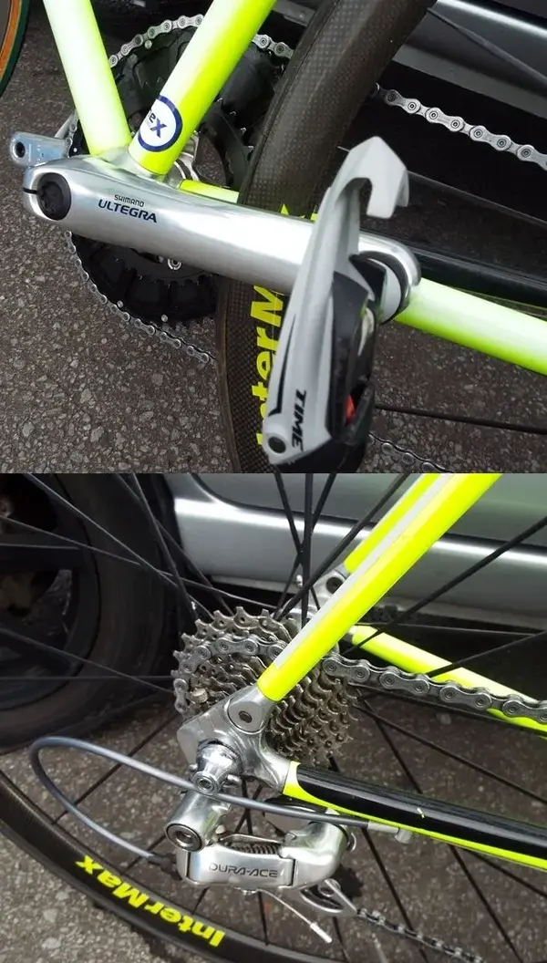

There is a triathlon adapted TVT92 on sale near me. Some say that the forks flex.
I would just like another horizontal top tube carbon bike. I wonder how it would compare with my Look KG 386 from about 15 years later, maybe.
These don't look original forks to me, hence not sure why worrying about flexing? Never seen this colour combo before either, off white, or is this just a bad photo?
Thank you. I don't know anything about these bikes and I am a worrier, rather than deliberately out to spread FUD.
I see that in comments on forums about them they are sometimes said to flex.
There is a video of a retro modern competition between a new carbon bike and a bike of a similar age but different and the flex can be seen in the video though whether desirable or not I am unsure.
I am not after a retro bike just a carbon bike with a low head tube.
It is just a bad photo. Other photos show that it is still my favourite fluorescent green. That is another reason why I am thinking of buying. That and that it has a hollow tech crank, by the look of things.
So is the TVT92 frame pretty much as fast as a modern carbon bike or does it handle like a noodle, or somewhere in between.
Well, it won't behave same as modern carbon frame, which has reinforced bb area and oversized tubes etc., as simply is built #completely differently, with carbon bits glued onto metal lugs. It will flex a bit, but not as much as lugged alu frames such as Alan or Vitus either - have both, TVT92 HM and Vitus BTW, so speaking from an experience.

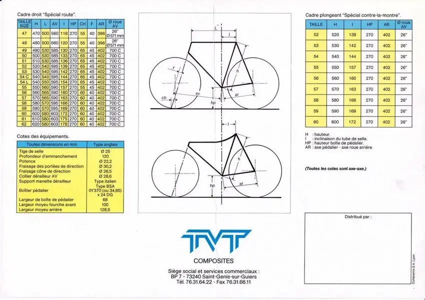

I do not know what bikes have short head tubes. My size is 54 cm. I want to ride carbon (or perhaps steel or titanium). My look KG386 has a 10cm head tube. I would like to put a more negative angled stem on it to make that a bit shorter. I can't seem to find 54cm carbon bikes with head tubes less than about 14cm. If you know them, please let me know.
... here the original GEO-Sheet by TVT92 from 1991 - length of steerer isn't specified
Thank you. I think I can tell that the head tube is short from the horizontal top tube and
the fact that there is not tube visible between the top and bottom head tube lugs. I also
look for bikes with drops about level with the wheels.
