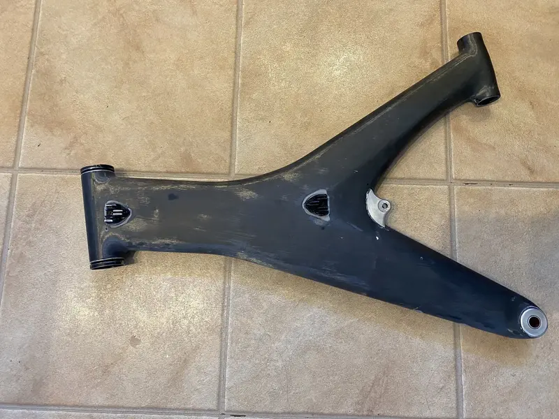

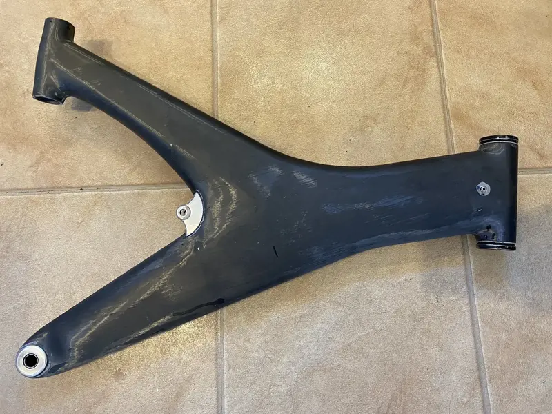

Finally after a few hours of sanding I have the Trek Y back to carbon and to a blank canvas 😅 I was really tempted to leave this frame naked carbon or with a tinted clear coat, but after much thought, planning and probably 10 different paint job ideas 😂 I have decided to paint her! Hopefully will get to lay some paint over the week or so 🥳

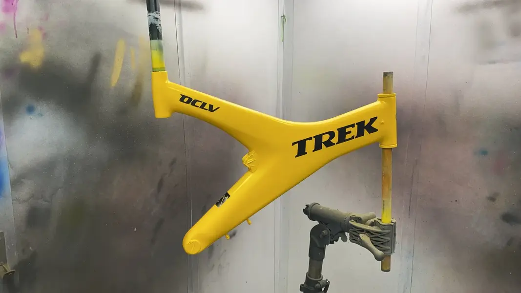

Build update

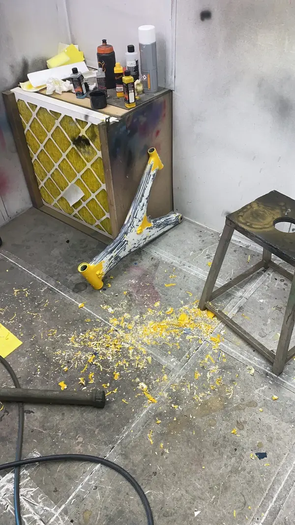

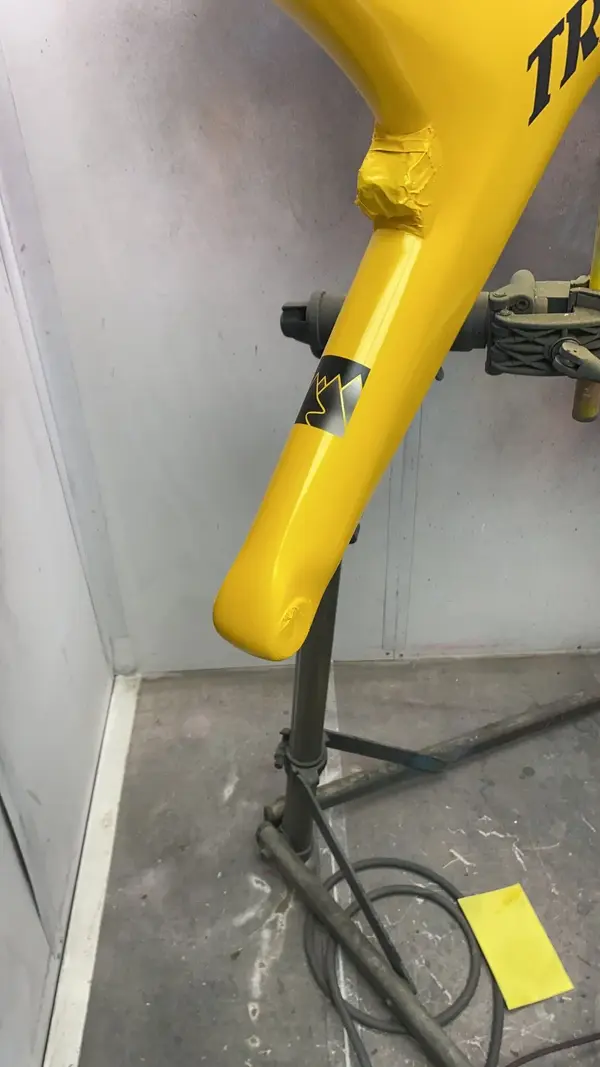

Yesterday I decided to paint the Y yellow with black decals and all went well! But once finished painting and getting ready to lay the clear coat I thought is this nice enough 🤔 and I think all I have really created is a replica of a paint job already done! So I decided to strip it all back again, 11 hours work stripped off just an hour after finishing it 😬
So back to the drawing board

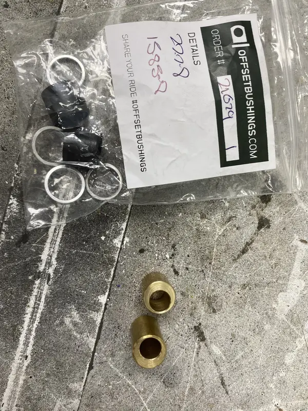

When I bought the frame it didn’t come with a shock but luckily I had an old Rockshox monarch of a Cannondale scalpel I once had which is 165mm so that’s worked out perfect, but I needed bushings so this is where I started thinking about the geometry of the bike and as it’s going to be a rider I also want to make this ride as good as possible. The pace forks that are going on this build are going to be converted to 90mm which will raise the bottom bracket and slacken the head angle, so I have bought offset bushings which you can have made to spec, this will lower the bottom bracket and slacken the head angle a little more too! So if all goes to plan the bike will have a more modern head angle with out effecting the bottom bracket height! Win win 🤩13665501-45AF-48A2-A43B-73DF5CD0B4B7.jpeg

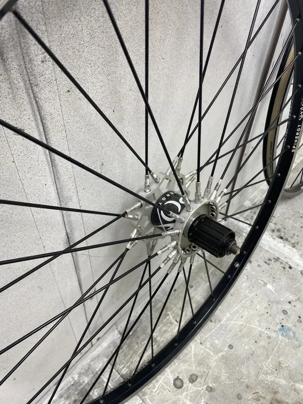

wheels and rear mech
Not too much to add (run on about)

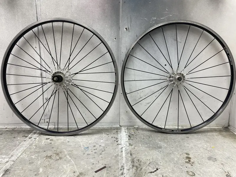

I really love the look of the Spox wheels and when I got a chance of a pair I knew I had to have them, they are fairly light too at 1650g I think and should look smart too on the build, I really didn’t want carbon spins or rev’s although they look really cool my build is more about building a nice riding bike I can happily thrash around Thetford Forest!
The rear mech I picked up off eBay for a good price and it looks even better than I thought so really happy with that 🤩
