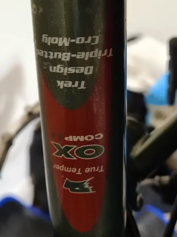

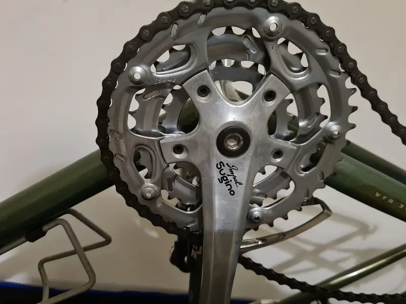

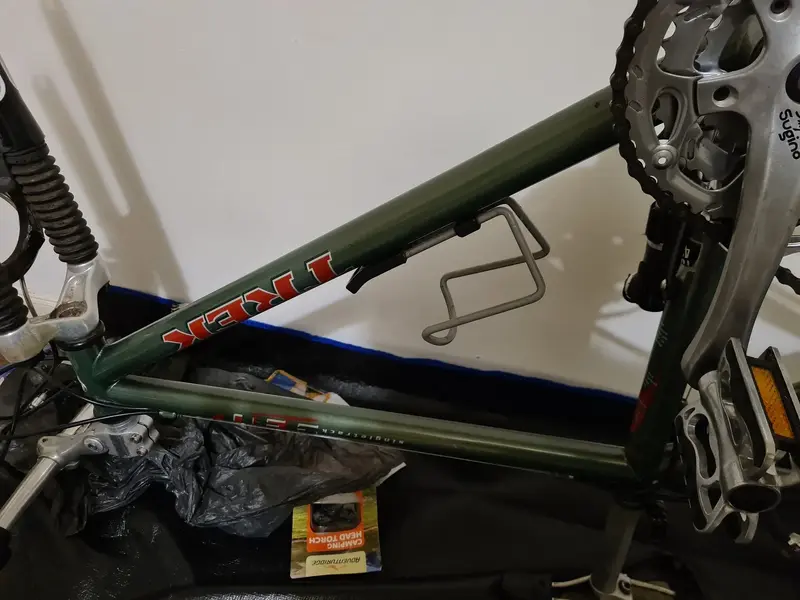

Hi All,

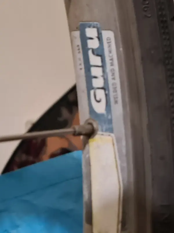

Bought a trek 930 bicycle predominantly for its" handbuilt in the USA "cromoly frame. Don't know the circa of it but I'd say 1993-1995. Also I had mighty 900 sugino cranks on my 1995 kona explosif and loved them...so sugino impel attracted me.It has sram shifters 700 esp, the explosif had 900 xrays which never missed a change. .. I'll post some pics. All in all it reminded me of my kona.. Its got some rust. I'm going to restore it and upgrade bits. In the interim I noticed the rims. Guru and hand made in the USA. They are for presta valves. I don't know the hubs, wondering if they're worth keeping, are they worth anything etc.?? Any information would be appreciated. Apologies for orientation of some of the pics but I'm in process of cleaning and dealing with the rust. Additionally couldn't help but purchase an m739 xt rear derailleur in interim.
Should I keep bike stock? Improve how? 1x10 upgrade? Thanks in advance for your opinions .20210417_011015.jpg20210417_011006.jpg20210417_011015.jpg20210417_011135.jpg20210417_011006.jpg20210417_010951.jpg20210417_010944.jpg20210417_010449.jpg20210417_010410.jpg

Guru rims were part of the Matrix line of components, Treks in house brand. Nothing wrong with them at all, totally original to the bike and absolutely in keeping. Front hub is likely a Matrix or a System 1, again Trek in house component and well suited to the bike.
Goes without saying that the stem needs to be replaced, that thing is a boat anchor and will flex and creak. Get a nice ahead stem to replace that.
It also looks like it may be worth testing the chain for stretch. If it is then it will need replacing, and if you do that you’ll need to replace the cassette as well.
As far as other upgrades, keeping it stock is great if the bike is sentimental or meaningful, however if you want a great bike then look at the gears, then forks. Wouldn’t bother with 10 speed upgrade, too many parts involved for very little gain.

Ahead stem is a must. Rigid steel forks as opposed to the base rock shox, project 2? Or is there cheaper to be had ?. This bike has no sentimental value. Kona explosif is another matter. V brakes will be upgraded to xt or xtr. I'll keep rims and hubs then. I will upgrade cassette even without chain stretch.. was looking at them xt used m737/m739 should be OK. Have bought rear mech m739. Sugino will stay. Shifters?? Combo or separate? I was actually thinking of using later spec shadow tech rear mech 9/10 speed as I was under impression they can be dialled in for 8 speed? Front mech could be a later variant also..

I agree. Having revisited m739 groupset last night... m739 functionally over m737. Would consider the m739 brake and gear shifters to replace current sram with m737/ m739 rear mech and front mech.

A friend offered to get the frame stripped and then powder coated.. don't really want to do that. Have applied water based rust treatment- gone hard and black.. would like some of its injuries to be seen..
