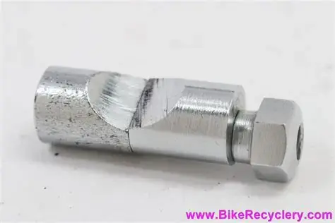

@Woz , yes that is pretty similar, I must say I thought it was more for aesthetics than aero and maybe also a tiny bit of weight saving - since there is no need for conventional binder bolt or ugly seatpost clamp. It does allow you to see how thin the ti seat tube is against the seat post which is both impressive and scary in equal measure. I think this arrangement would work best on thin butted steel TIG welded tubes as with ti there is a lot of welding around the hole that is needed to house it. I think it has a satisfying simplicity about the mechanism though in the same way quality U-Locks do.
