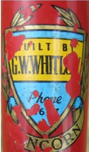

I have manage to find a pic of it (albeit no detail to see the decals - I remember them being on a gold script, perhaps Georges signature, with a blue and yellow shield shaped head badge…
So here it is, in full flight in around 1977 with my dad astride!
Like this?

Re: George Whitlow transfers
Amazing what can turn up.
Steve at Lloyds Decals could probably knock up the necessary artwork from that image and recreate some transfers. If the downtube transfer name was originally in script he could probably conjure something up that wouldn't have been too dissimilar. Might be worth checking through old trade directories at the library to determine G.W's telephone number for the head badge - the bit that's missing.
Shaun
Overbury’s font would work for down tubes. If you want decent pics/measurements let me know. Or ask Gil m.
