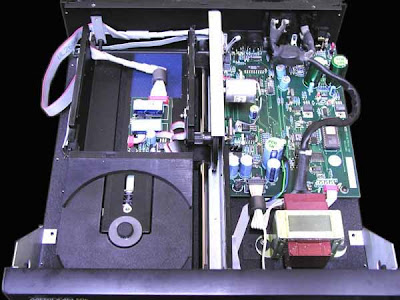

Can I butt in with a question about my Meridian 506 CD player?
I'll assume that's a 'yes Neil, please do.'
It will no longer see the CD when inserted. This started as an occasional / intermittent fault (the worst kind), then became a bit more stubborn and finally it just will not play. In between the intermittent bouts, it would play perfectly.
I have done some reading and pulled the transport to bits, but the gummed up grease that most on-line advisers talk about was not there, everything is fine. It is also possible to watch the transport 'kick' the platter when you power the player up, but when a CD is inserted it does nothing.
Terminal or repairable?

There are quite a few models of the 506, the first one had the Phillips CDM1 or CDM Pro mechanism (I cant remember which) - these were very quickly replaced with a CD-ROM based (CDM-12?)mechanism. Later models may be repairable but the early models are very difficult to find spares for.
You may be able to turn up the laser via a circuit board preset but I was told this shortens the life of the mech. The presets are often labled 'gain' 'focus' etc, etc. Its been a while since I had a 506 so I cant remember what is what.

I'll have to pull it to bits again, but from recollection I would say it has the CDM 12.
Is it likely that the laser is just tired out then? If so, I may do some hunting, otherwise it can go in its box in the loft next to my Yamaha that I bought about 20 yards ago and which eventually skipped more than a bunch of 8 year old girls in a playground.
This would suggest the CDM12 mech too.
There's often mechs of all kinds on eBay for sometimes reasonable money - in fact, just had a browse and there's loads starting from around a tenner. Worth a punt!

YUP! That's the kiddie.
Cool.
Off to ebay to see what I can find, thanks guys.
