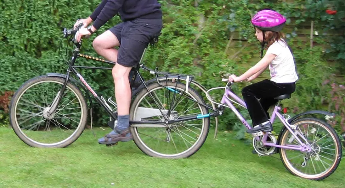

True, but increasing the diameter of the disk also increases the leverage working against the rotation of the wheel and so increases the chance of lockout when unladen. A better solution would be to use vented disks of a smaller diameter. These are effectively two side by side disks joined together. They have vent holes to help the heat escape from inside the gap.
My 1983 Cleland Aventura shown below has hollow brake drums that allow the heat to escape through the entire hub. A system that works well when towing a heavily laden trailer.
I agree that what matters most is mass of metal - however drums do have the disadvantage that they expand on heating - not great for improving braking with heat. I don't know how badly they fade on the front, but of course the Arai rear drum is a tandem classic. I'd love to see a comparison of wear between drums and disc pads - tandems absolutely eat disc pads. I've come across a Cannondale tandem that ate a brand new set before the end of the Exmoor Beast, with unpleasant consequences.
