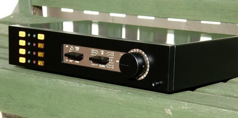

Jeez, this 34 is fighting me all the way!
Sorted the input switching out (logic chip fried). :) Testing the audio path tonight - no output both channels. :facepalm: Traced it to the tape monitor logic gate, its also fried because if I short the signal path through it, signal gets as far as the output mute circuit ... where it stops :facepalm: Output mute circuit is not switching out of mute even when the PSU is stable... I suspect a leaky transistor after the comparator. I'll sort the tape monitor logic out first (parts on order) and then think about the mute circuit!
Still, at least it should be ready for the hifi selling season!! :lol:

Yay! Sorted the tape monitor switching at last :)
Just need to sort the 'mute' which should be simple. It's all polished up and looking like new and almost ready for a new owner.

Finally complete!
That was 'challenging'. Replaced pretty much every IC involved with the switching logic, several bits of the mute circuit, two LED driver transistors, and all the electrolytics - before I even thought about upgrades! The paint's not to everyone's taste but I like it :)
