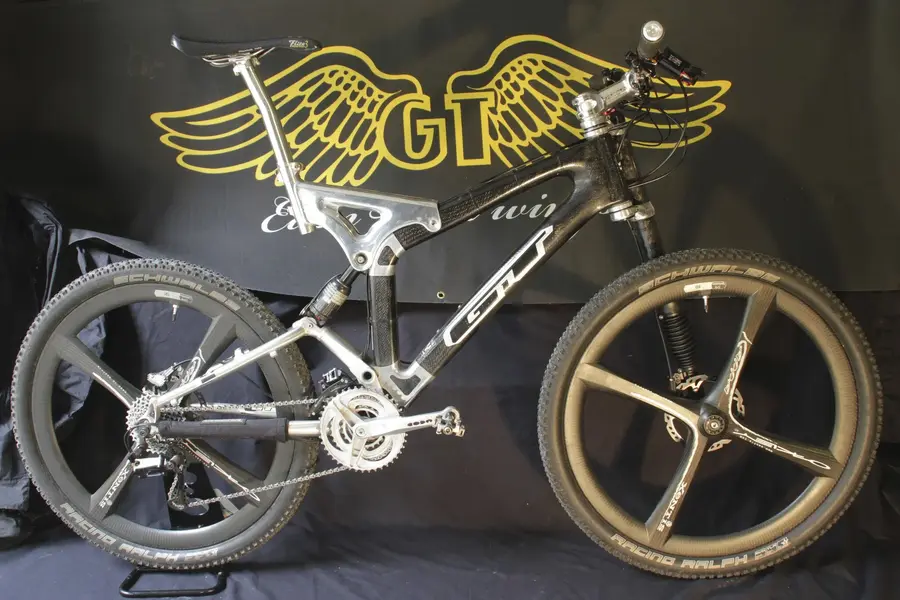

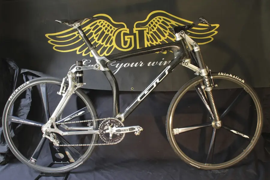

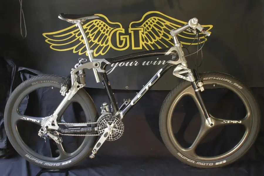

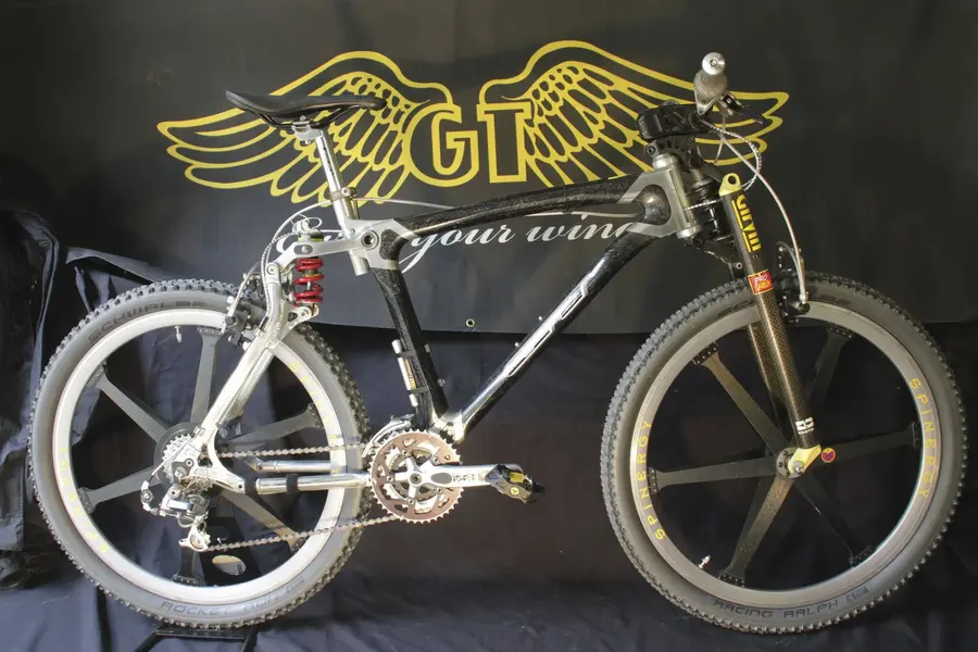

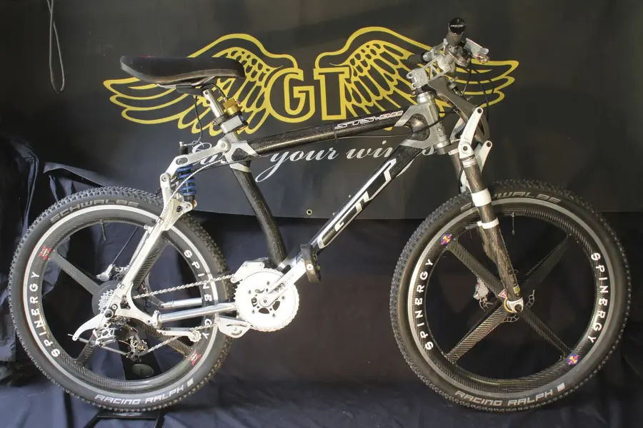

Hi all. Very happy to share my STS family, now completed, from 1996 to 2000 :
