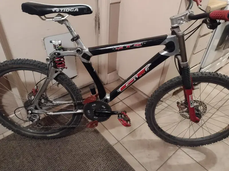

I guess I need to post my STS DH here. Looks to be almost all original. Saddle doesn't seem original but that's about all I could find.
I think I'm keeping all the period correct decals on it. Keeping it vintage.

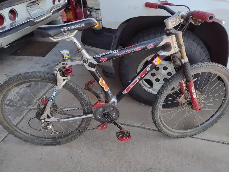

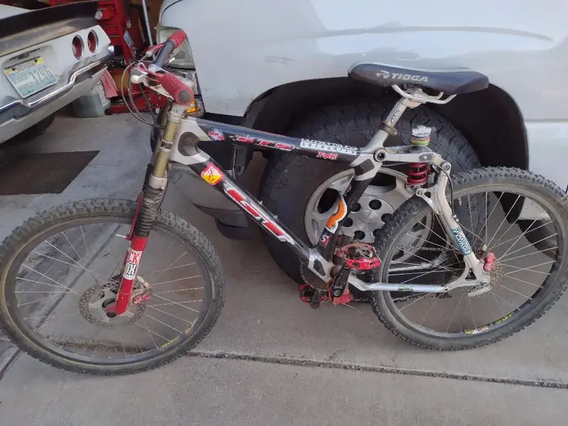

I decided to Kill Kenny and remove all the non original stickers.....

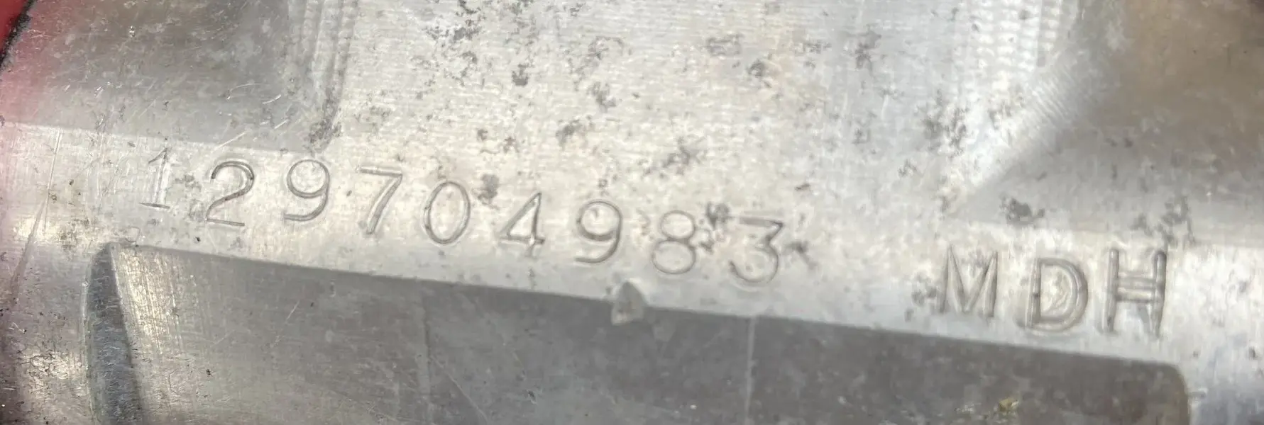

I picked up a 97 STS DH frame a while ago that looked like it had spent some time sat outside abandoned, it did have the AC chain device, some White Brothers forks (beyond rescue), X-Lite seat post, what look to be Azonic copy stem and bars and a few XT bits. I checked it for cracks and looked to be fine, at the bargain price it wasn't going to be the end of the world if I found something. Unfortunately when I got it home and cleaned it i found a crack at the top of the down tube side of the BB lug. I have decided to build it up anyway, here are a few photos.
I do have a few questions if anyone can help? All my retro builds so far have been hardtails and I didn't have an STS back in the day.
  • It doesn't have disc mounts on the rear, I have seen a few photos of other 97 STS DH that didn't have them and are running XTR V brakes but the catalogue shows the Formula disc brakes. What is the deal with this? Are the ones without earlier?
  • Crack in the BB lug on the top of the downtube section – I am guessing it cant be welded as the heat will melt the thermoplastic? I have seen people drill holes to stop the crack, also liquid metal an option? I am not going to ride it in anger and it will likely be up on the wall but would be good to fix.
  • I picked up a reasonably priced DHO, it’s not bad but the steerer is a tad short, I have spare steerer tubes from some Judy XC’s and SL’s but has anyone swapped the press fit steerer tubes over? I know you’re not supposed to but I see a few have done it. Alternatively if anyone has a DHO crown and steerer let me know
  • I have seen a few with the gold seat post clamps, is this of any relevance or just a retrofit?

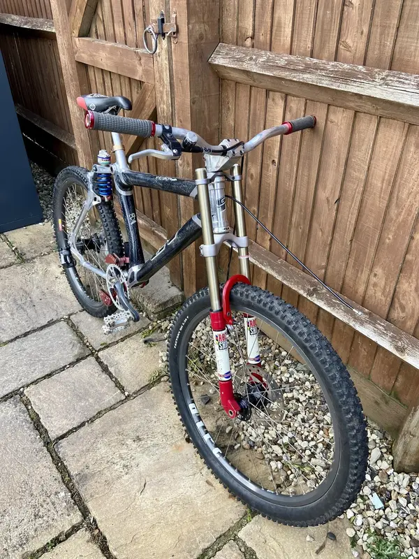

I haven't had much time so this one has been slow progress but getting there.
Anyone?
- Discmounts only on the later models.
- Crack in the BB - Well. Thats it, basically. I haven't heard of or seen anyone able to repair that kind of damage. Altough I have seen a new to me welding technique recently. Someone welded a few rust-holes in a FatChance steel frame (I think it was) using laser-welding. It didn't burn the paint so the heat was held in a very small area. Maybe this would be worth looking into? I have no idea if this is even a thing on Aluminium parts.
