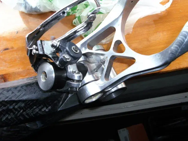

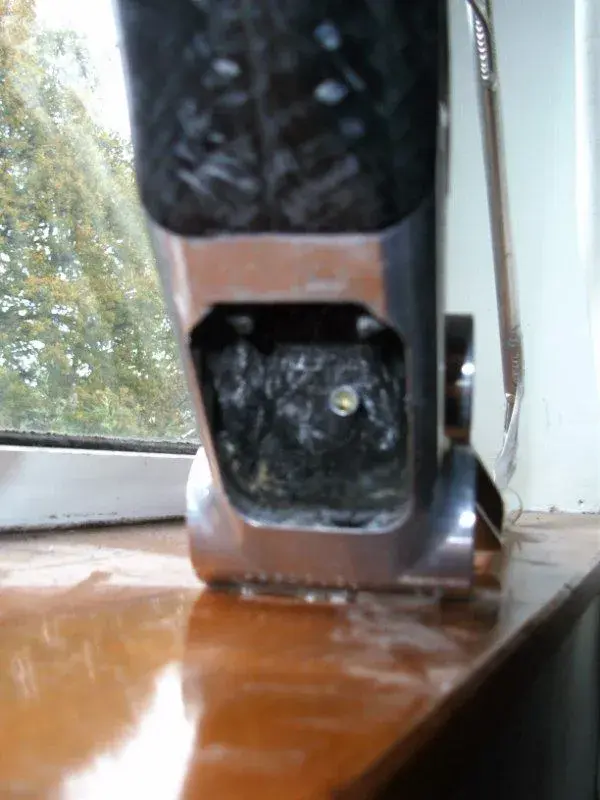

Just a little mod to my STS, noticed where the front mech cable came out, it had cut a groove into the surroundings, so had a flexible v-brake noodle, so cut it down and then fitted it through the hole (drilled out the hole from 4mm to 4.5mm), am going to run full gear and brake outers through the frame.
Nice mod matt..
Looking at mine, it just has some rubber outter, and the angle of the cable to the frame is pretty aggressive.. i am concerned about the cable cutting though. Might look into a similar mod to this.

Did some minor work to the bike (still havent ridden it).
One thing was copy matt's idea.. so i have a 'vbrake noodle' for the front derailer now.

Also rounded the top bolt for the bushing when torquing it down.. >:(

gonna get a tube spanner to get the nut undone, seeming as though in rounded the bolt
