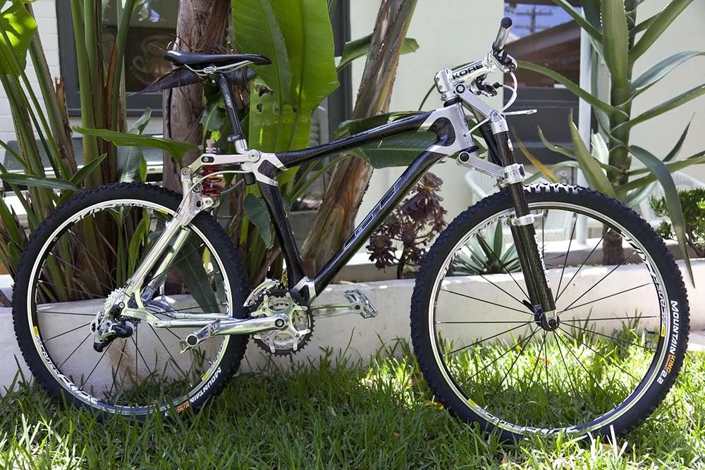

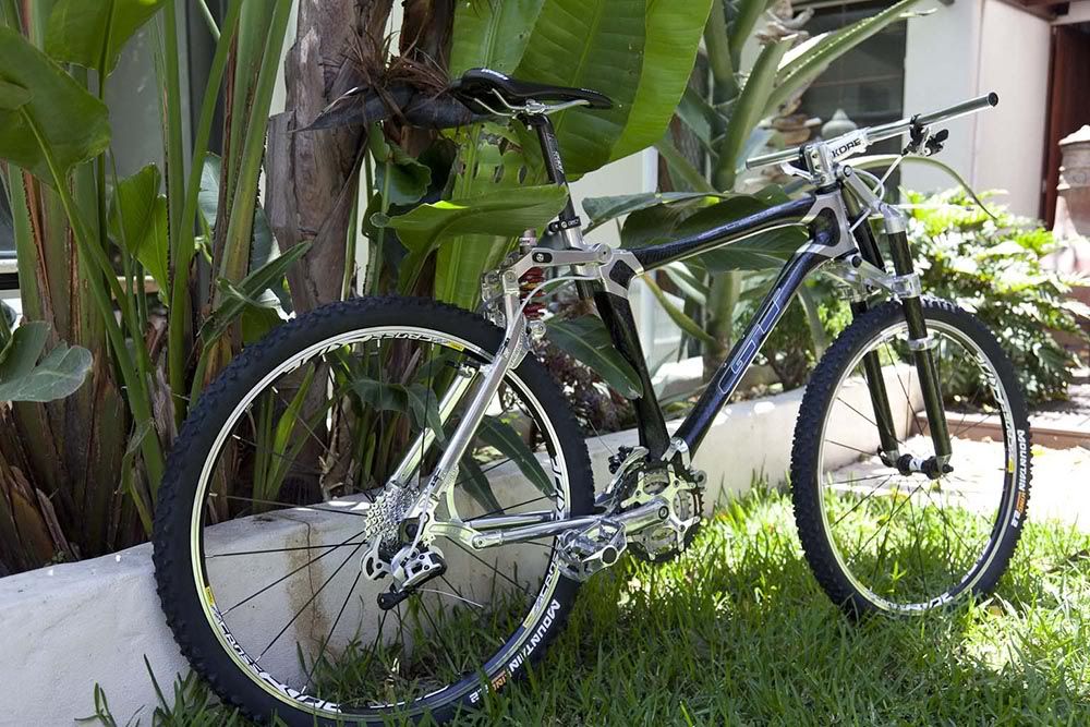

The previous owner of mine said he got the frame new in 2006 (says the frame is a 96).. And he built it with then modern parts and raced it for a season then just stored it.. I paid 1k.. not a bargin but reasonable..
Just regreasing, replacing some bolts, bottom bracket and other parts (impatiently waiting on various things to get delivered).
I will post some pics once i have finished it.

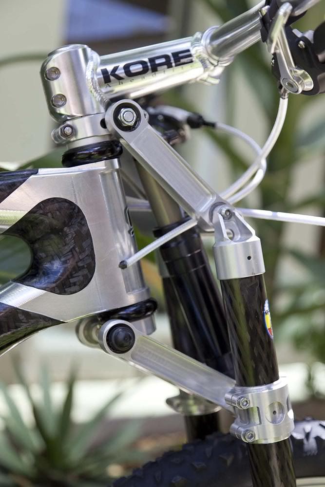

And on a side note..  Got a new bolt for the top linkage.. As presumed it was a standard Counter-Sunk bolt, got it in stainless, was a bit longer than the stock one, so i just hacksawed an filed it down.   Got a new flange nut for it too in hi-tensil (they didnt sell stainless).
To remove the original nut and bolt, i got a 7mm tube spanner to undo it, and just jammed allen key in the bolt and put pressure on it so it wouldnt spin.. new nut is 10mm wide..
