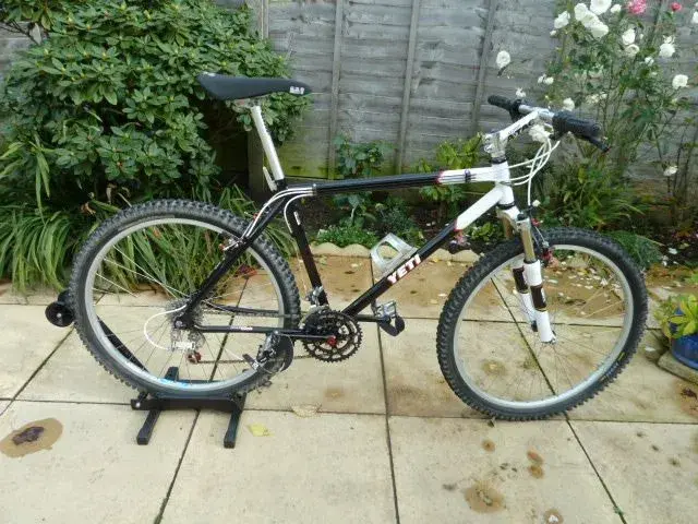

Hey Nick,
This bike took a hell of a lot of patience to get fixed(not to mention money, time, e-mails etc)
You would not believe what it means to me to have it done and now ridden.
Just needs a Ringle, Cook Bros, Onza seatpost and some other little bits.
The gripshift paw covers came form you mate.
Thankyou for the kind words.
This is going to be one of those bikes that keeps getting parts swapped around back and forth till i
find my favorite look. Ive fitted a temporary stem which is slightly shorter and higher. My friend as
borrowed The Critical Racing stem to copy me a shorter version out of billet 8)
I have a couple of other parts on the way too for this build. Ill keep updating.

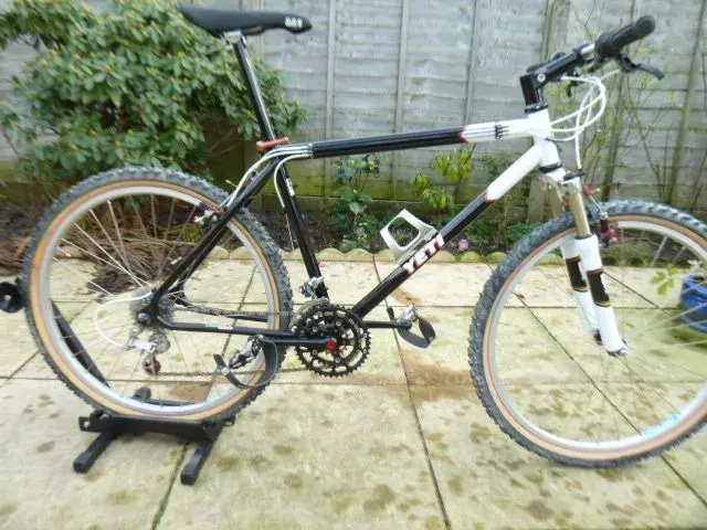

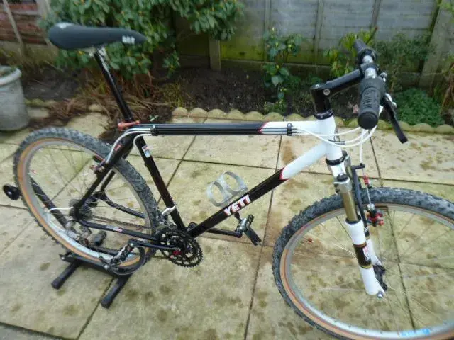

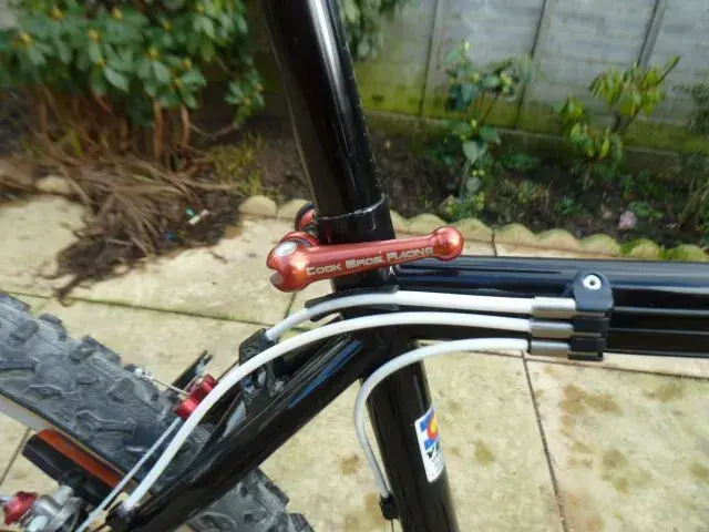

Ive made a few changes to the YETI some to make it more comfortable to ride.
1) Ringle stem 120mm (Critical stem was way too long at 135)
2) Ringle moby setapost (inline to bring the seat angle forward)
3)Cook brothers seat QR
4)Panaracer Duster amberwall tyres
Like i said last year this build will continue evolving/morphing until i find the correct ride and look
