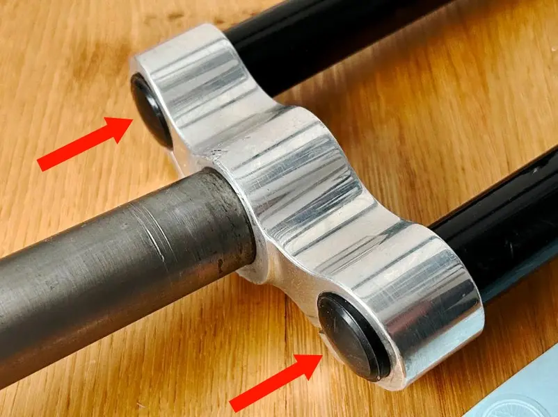

Does anyone have a source for replacement top caps for syncros powelite forks?
(photo from @fguki kleinanzeigen listing)

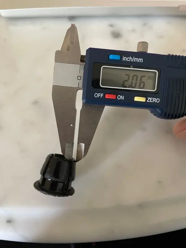

Heres a bit more info:
The wall thickness is around 2mm, spit into 4 tabs, inner diameter is around 12.5mm.

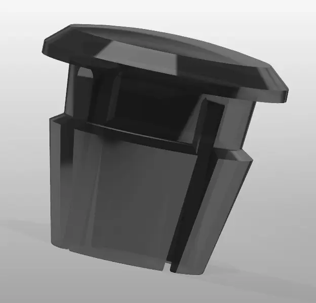

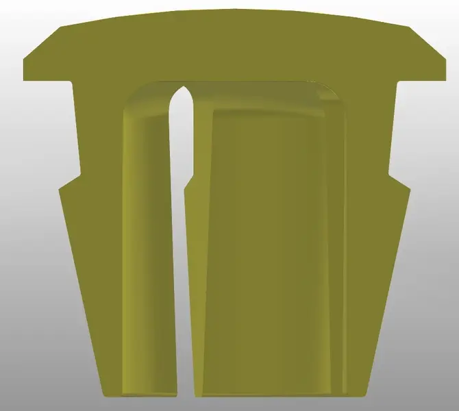

Now modelled - some images below to show profile and section. modelled to given dimensions.
Retrobike won't allow me to upload the model files so I've saved to google drive folder available here:
https://drive.google.com/drive/folders/128gPSz0Co4u6i5dWJCM72iX5svkFOXcX?usp=sharing
I've saved in both STL and 3MF formats which should be good for printing. I've also added STEP file which is good if anyone ever needs to modify.
