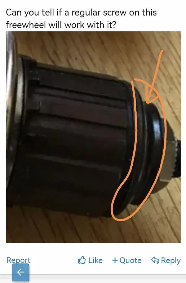

As there is no actual picture of the hub or freehub body, I cannot say.
Or even if it is actually MD.
MD have the large black seal showing
7speed have a silver bit showing next to it, 8 speed doesn't.

Very useful input. Here is a close up picture I received from the seller.
Can you tell if a regular screw on this freewheel will work with it?

I am still undecided on them. If any screw on freewheel can fit or one that I can slightly modify then no problems.
If I have to rely on finding MicroDrive and stock on them then I am having 2nd thoughts already…
It's microdrive and will only fit the microdrive cassette.
It looks like there is a flash of silver just past the end of the threading.. so 7speed.
But a picture from the axle end would confirm either way.
