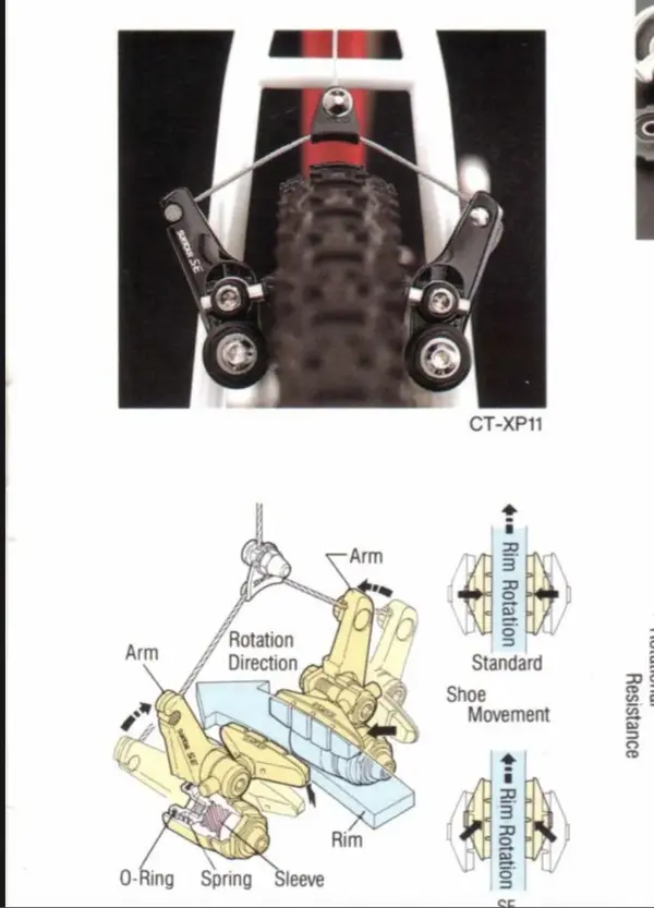

I am in a dilemma as I am between buying the Suntour XCE cantis pictured below and the XCD ones.
Do you have any feedback on which one is a better choice?
I am asking because the XCE model has this strange idea of having the cantilevers extended to the direction of the wheel when breaking.
The XCD seem to be standard technology so like most other cantis.
Thanks for any feedback you might have!
Yes. They are a Pedersen design. Should be more powerful.
Available here for £9 pair!....were £4.99....bloody inflation!
Just dont use them on the front..unless you have rear mounted cantis....as they try to pull the brakes off the rim that way round!

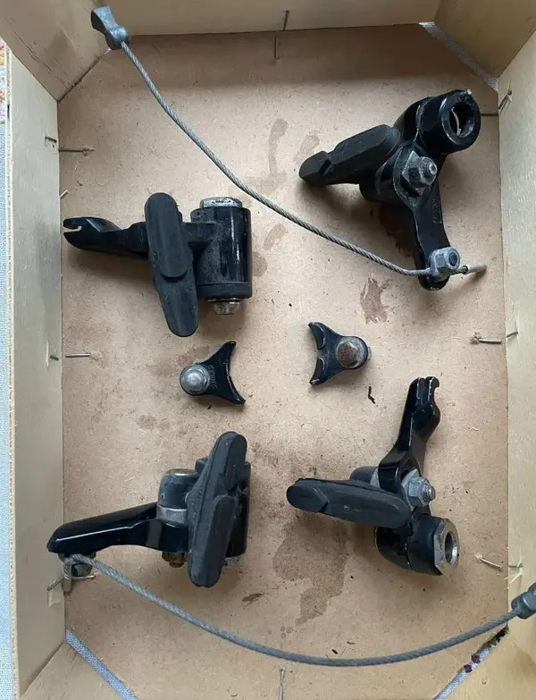

I found a pair of XC E that will need some work to revive…
I just hope their “sliding” system still works as intended.
I will let you know here how it goes…just curious to see if they offer more modulation than regular cantis. I can already sense though that if their technology really offered something new it would have eventually been copied by others too.
Unfortunately not, they have a reputation for being quite grabby in their operation with little distinction when they will bite. Although the pair I had (rear wheel) was feeling normal. I guess it also depends on factors like rims, brake shoes etc
Oh god! What did I get myself into…just purchased them in the meantime…
I guess I self fulfilled the title of the thread…😅😂😁
