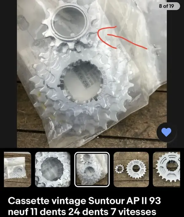

You need to double check that end to make sure.
That cassette will not work.
It has an 11T bottom cog, it was the first to bring in the 11T cog as standard. If it isn't 11T it is not an MD cassette.
That 11T will also have a 12T connected to it, that then screws onto the cassette end in the old way before the lock ring was used.
11-24T for 7 speed, 8 speed adds an extra 28T on.
There are quite a few threads on this.

About the splines.
