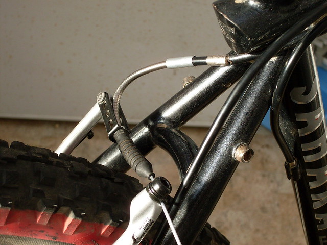

hmm if it was a good idea I guess they wouldn't have done this:
I can't find an example where the noodle is positioned well below the horizontal. I guess I'll just follow suit and use an extra six inches of cable...
You'll probably have to copy the picture as the noodle won't fit in it's holder pointing towards the ground. Unless you custom form one of course, but then I'd start with the longer 135 degree version.
Don't forget that you can get flexible noodles which might give you a bit of 'wiggle room'...
