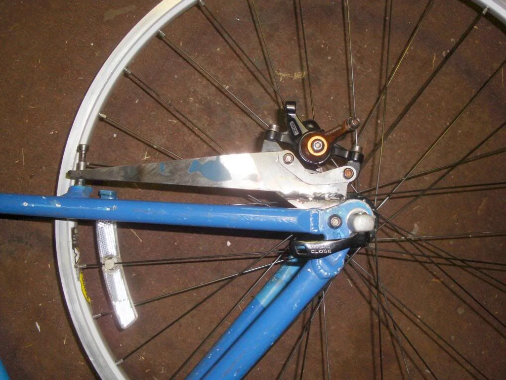

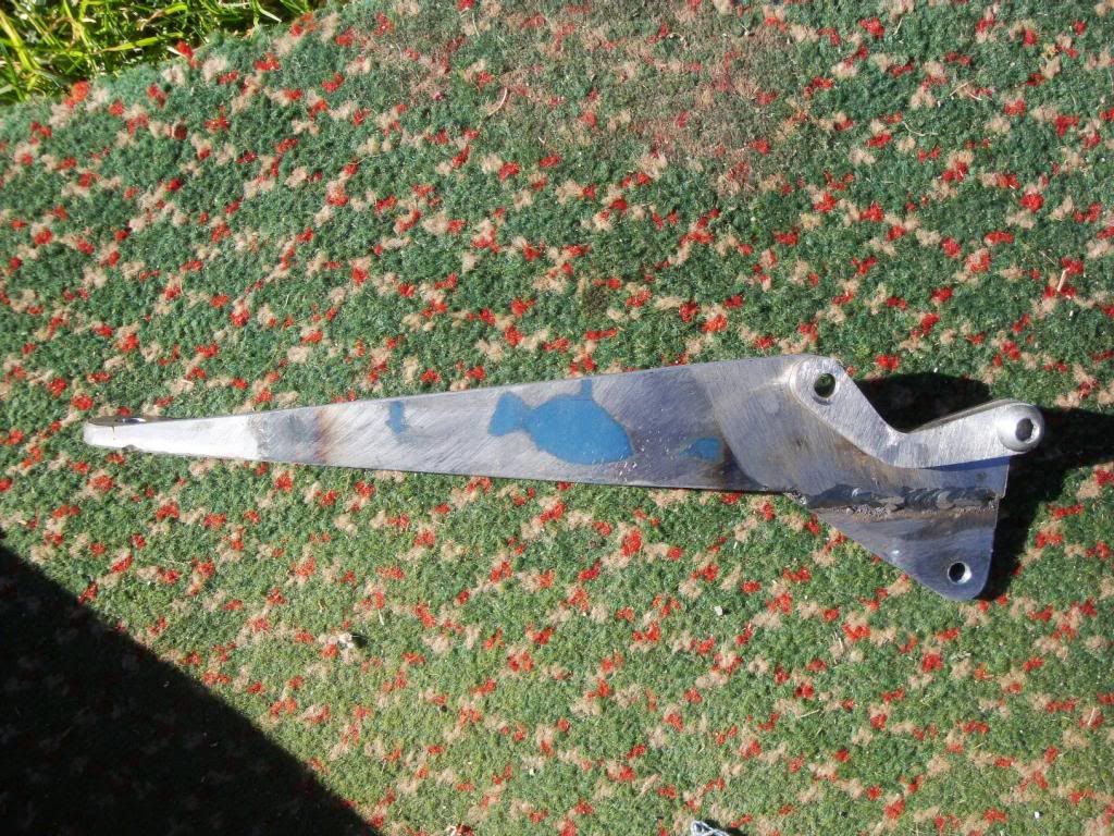

here is my prototype
and fitted for testing
also can someone weigh their fin, so we can compare weights
and the web thickness too would be good to know, and the pivot mounting too
to not fat matt
inovation thats what we need, how did you mount to the pivot bolt?

i'm guessing the original's weight at about 70g
my steel one is 250g
ps sorted the stay bolt problem
rotate the bolt loose the washer and it'll clear

Do you have any pics form the top?

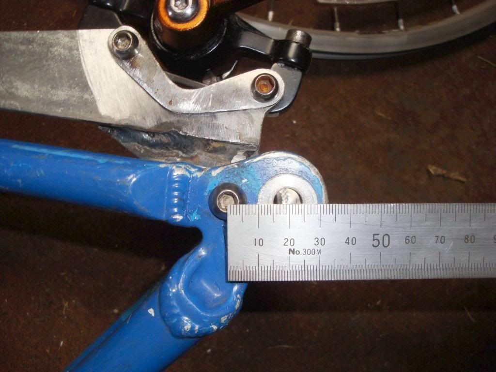

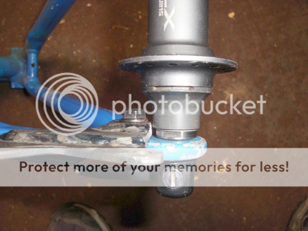

can you post a pic of the measurement to the dropout centerline
not that pic, the hole is offset to the fin hole by about 3mm????
the 99 one...
this hole is the crittical dimension

not a lot of room down there
@ 20 mm from the dropout
i can allow an extra 1 to 2mm, but will it fit existing stays?????
