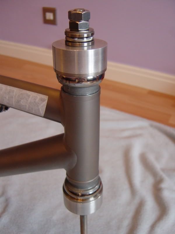

Headset press from my post above in use :
Worked a treat 8)

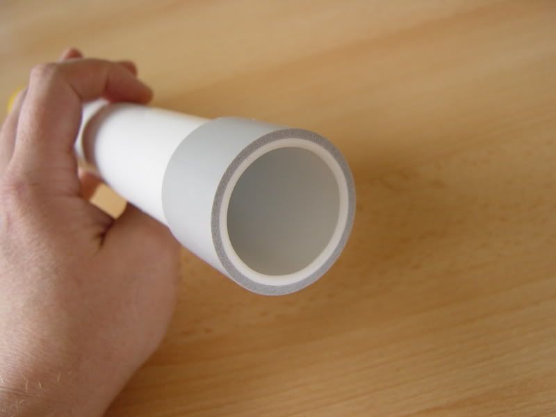

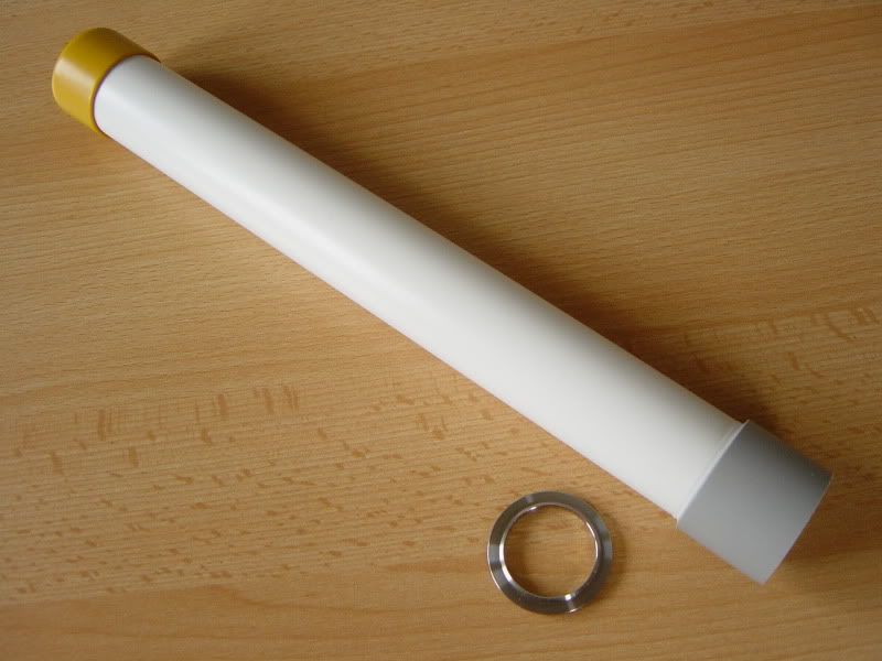

Crown race tool made from two pieces of plastic plumbing pipe :
I sleeved the end to help stop it splitting and chamfered it a bit internally :
So it fits a king race perfectly :
Also worked a treat 8)

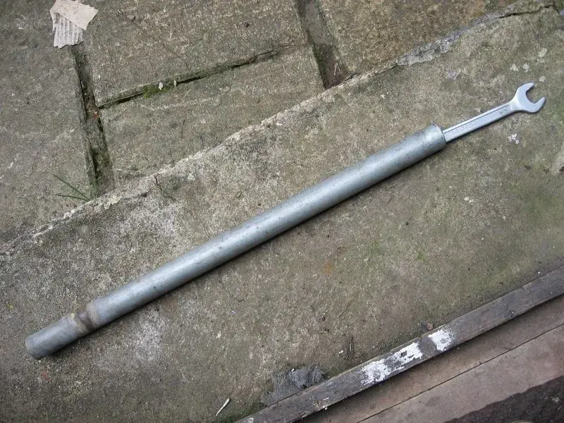

Not sure if it falls into the definition of home made tool, but this length of scaffolding and 24mm spanner has loosened BB cups and cassettes that everything else has failed - including holding removal nut in vice and trying to turn the frame or wheel.
For BBs I use it with the first tool in this thread.
