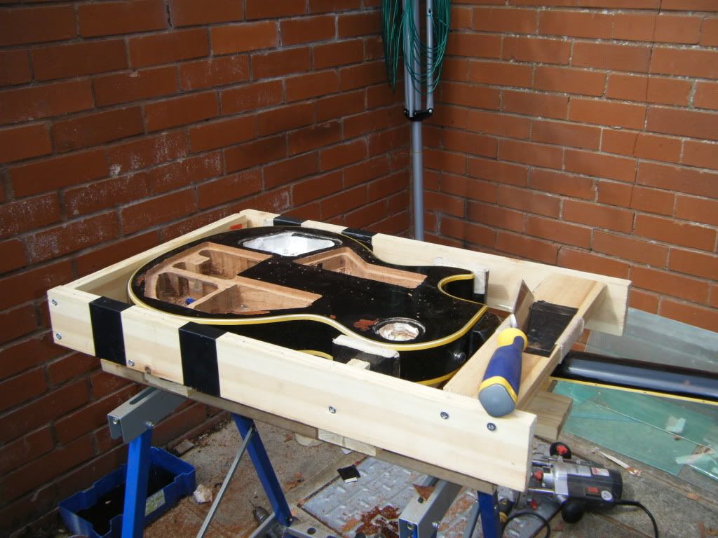

A jig: weight weenieing an '85 Gibson Les Paul Custom

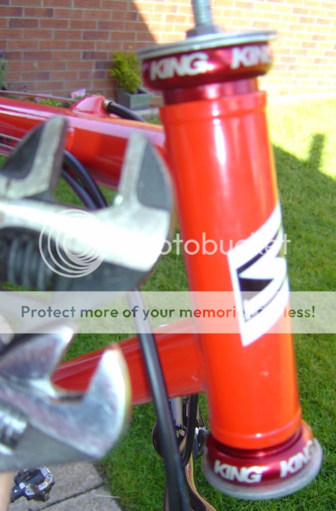

I used to have a Large Mechanical anchor bolt, stainless and about M20 I think, about 200mm long Couple of delrin washers and some nuts.
I used it the same as this for putting the headset in, but it was also good cos if you inserted it then expanded the wedge you could use it to drift them out squarely too!

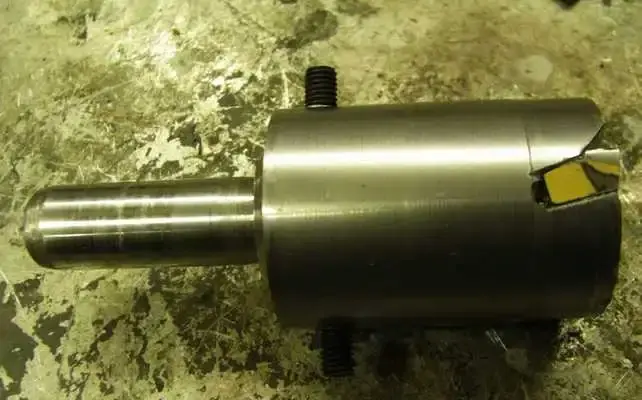

Bottom bracket cutter outer, removes the ledge from the cup so you can pull the bb out and get access to cut the cup.

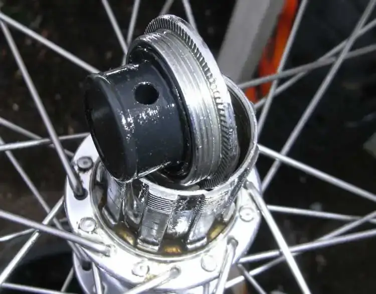

Freehub oiler.

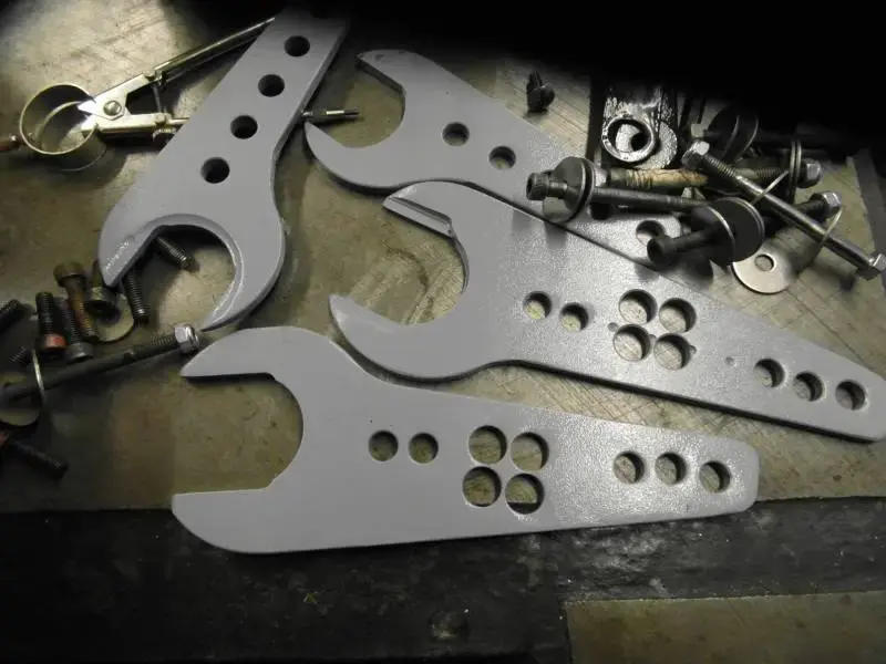

Headset spanners, 36mm and 40mm. In fact I have two 40mm ones I cut out for someone on here, he still hasn't replied to my message saying they are ready to post and they have been on top of the fridge since November! So if you need pair..
