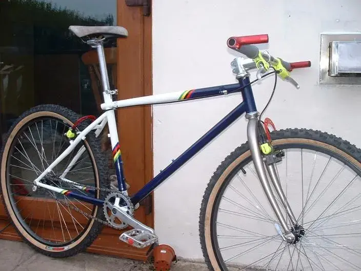

my pinnacle :D

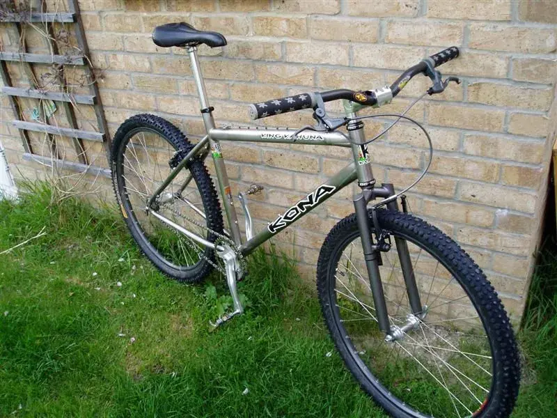

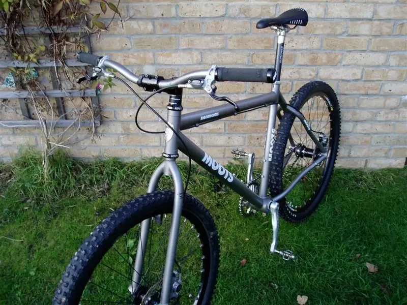

My Kona King Kahuna and Moots Rigormootis single speeds.
The lower pic is as the KK is now with the following in titanium; Syncros seatpost / clamp, stem, pedals, CK Headset, stackers, Black Sheep forks, ti railed flite, Hope ti front hub and a sprinkling of ti bolts. Also sports Avid Ultimate brakes with Flak jackets and 517 ceramic rims, rear hub is a WI ENO eccentric with WI 16t freewheel, Middleburn RS3 cranks with Surly 36t stainless chainring and ti self extracting bolts. Easton carbon monkeylite risers with ODI Ruffian lock ons.
I haven't used it for months as I'm always on the Moots ss these days, so I guess it may be in the classifieds as soon as I can be ar$ed / have time to strip it down. :(
All that's changed on the Moots Rigor is some new tyres, just fitted this afternoon.
