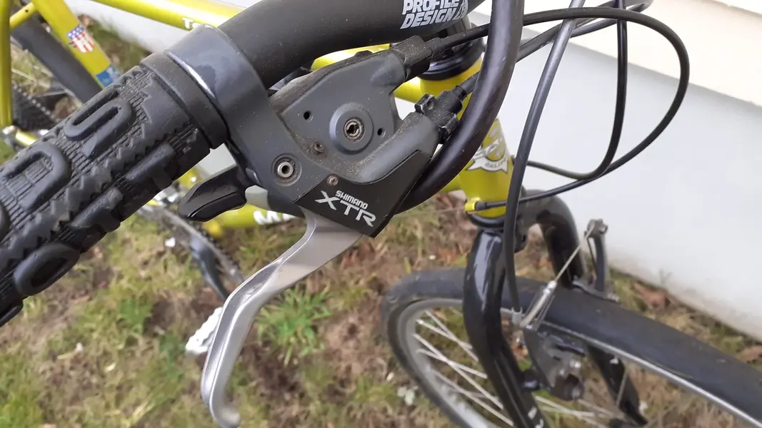

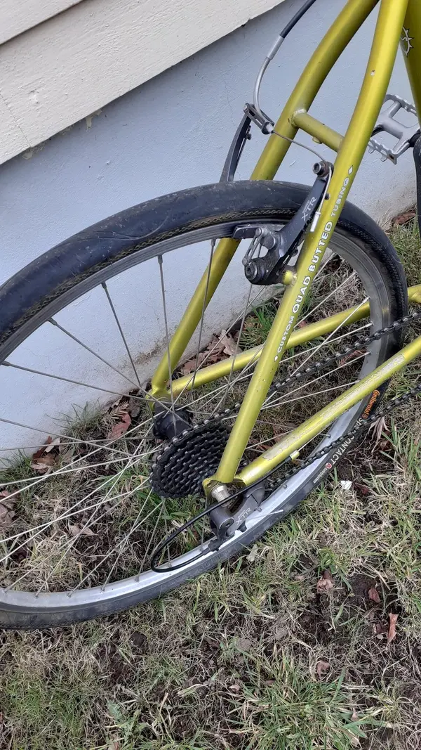

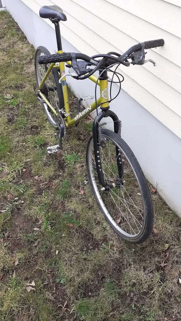

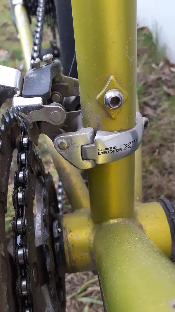

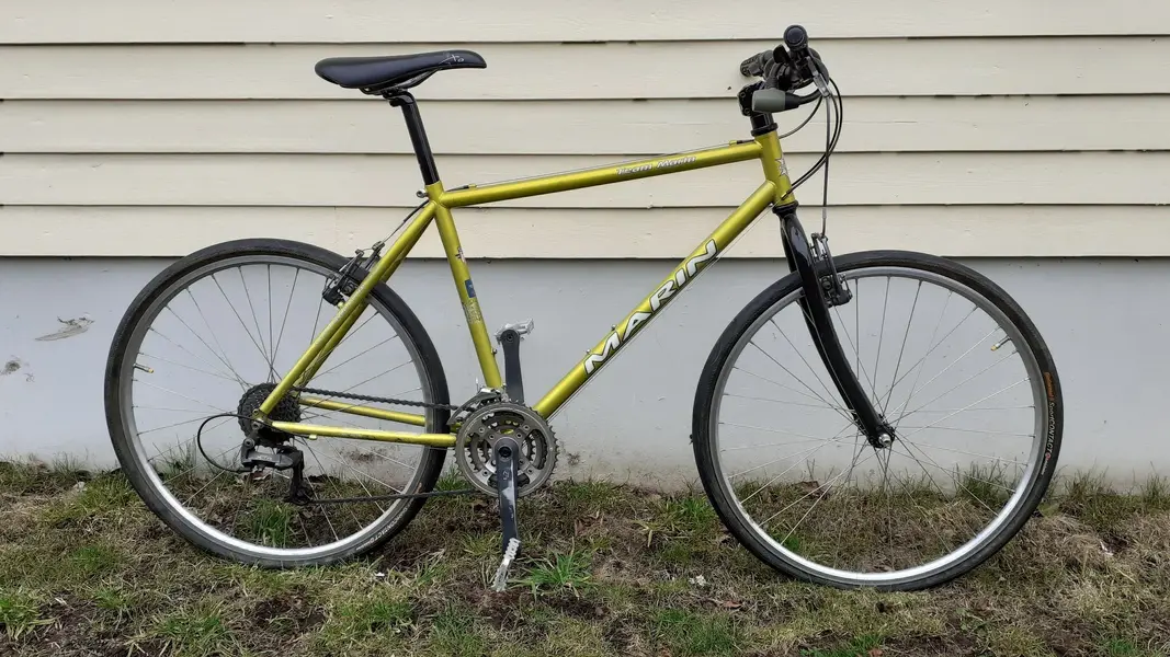

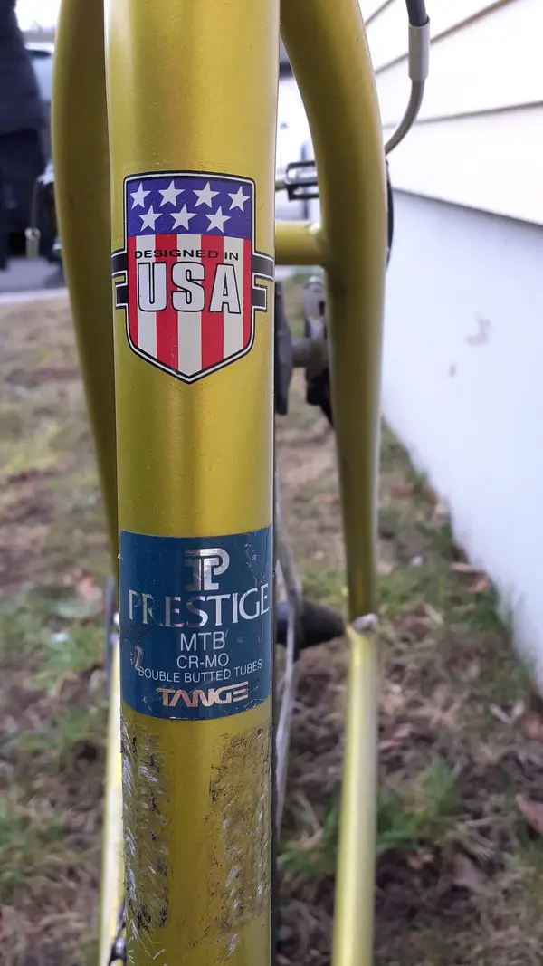

Just taken down from the from the attic, first ime in 6 years...
