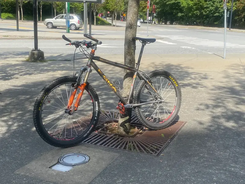

Just checking if some of the OG Vancouver members on here could offer suggestions on who still repairs old Marzocchi forks in town. Was out yesterday and blew the seals on my '97 Z1's. I did a quick check of some of the suspension repair shops but it looks like they all have some type of age limits.

If the bushings don't have any play you should be good with dust/oil seals. The foot nut o-ring is the only thing that can even leak besides the main oil seals. Dr Zocchi on this site sells the complete rebuilt kit with tools if you just want everything: https://dr-zocchi.projectweb.de/produkt/rebuild-kit-classic-z1z2-marzocchi/
Awesome, thanks for the reply, that would be a way better option then. Who would have the service kits?

Thanks for the suggestion

Great, guess that answers my question. Thanks very much for the help
😝 I just ordered one of your repair kits and an extra set of seals yesterday. That's an amazing project you're doing bringing this old stuff back to life. I'd heard about it but had no idea you had that much, I think I'll need to make an account. Next thing on the list is the Monster T's 😏Thanks for the reply, I'll definitely be in touch again
