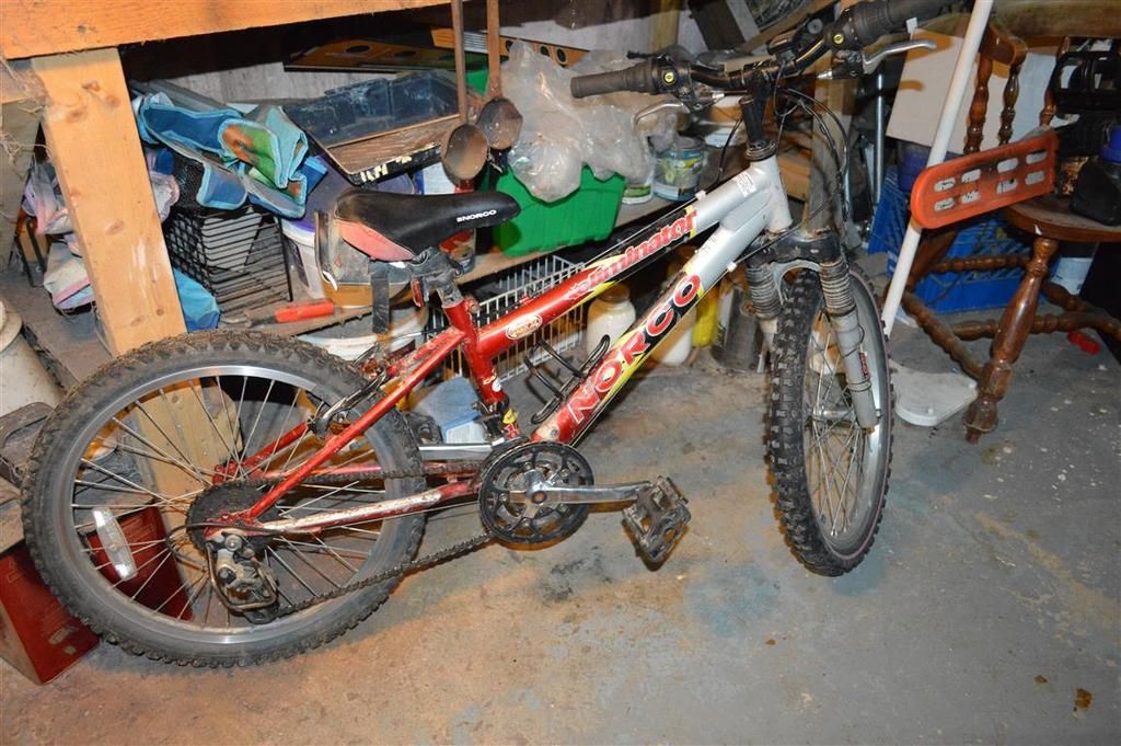

Rather an extreme case in my basement.... My wife and I have been working the last 2 years to get our kids into mountain biking. My 8 year old daughter's been easy, she's tall enough to fit a 15" frame 26" wheel'd bike, so commercial offering work well for her. I don't recall the crank length, but I believe they're 165mm Truvativ offerings....
My 6 year old son, on the other hand, rides an old Norco Eliminator 20" bike. All last season, he struggled on climbs, quite simply didn't have the torque to defeat more than a moderate hill. Looking at his crankset, it was a 140mm plastic coated steal POS, with 2 rings, 36 and 46 teeth, IIRC. So his 1st gear was 36-28. No wonder hills sucked for him.
I looked for some time, but was unable to find what I considered decent small crank offerings of any kind.
I took a beat up old pair of 175mm LX cranks, circa 1995, off a donor bike. I drilled them for a 145mm throw, and with taps borrowed from my LBS, I tapped'em and cut down the excess. I turned the big chainring into a bash guard. A bit of time with the polishing mop, and the job looked pretty good. Tools were hacksaw, drill press, tap set, disk sander, polisher.
Just for fun, I replaced the old Suntour FD with an LX also from the donor frame. Really lightened the shifter action for him, it was impossible before.
Sorry for the shite photos, late night basement lighting, LOL.
J
