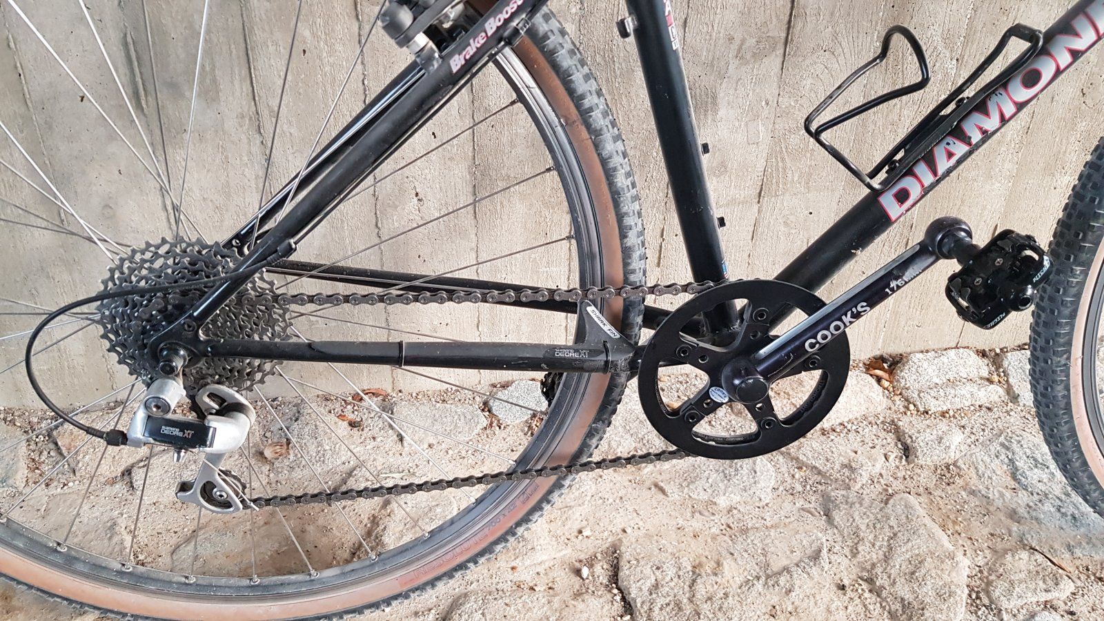

Maybe let's move on, what are your plans with regards to the rear mech? Do you plan to use a modern wide range cassette and 10+ gears?
Just this limits already choices and you will result in a derailleur in black and ugly (in my human opinion) anyhow.
I've done a lot of hacks, using 10 speed 11-36 cassettes with old rear mech, just to keep the classic style consequently.
https://fotos.mtb-news.de/p/2761181 or https://www.mtb-news.de/forum/attachments/20200916_185119-jpg.1117842/
You can get it work, but not as stress free as with a modern derailleur...

What are your plans with regards to the rear mech? Do you plan to use a modern wide range cassette and 10+ gears?

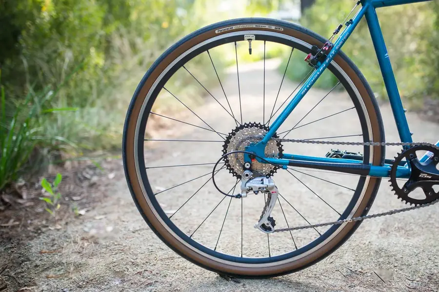

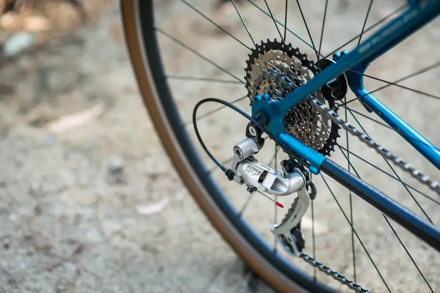

You'll be pleased to hear that I'll be running a silver derailleur; a used but servicable XT M761.

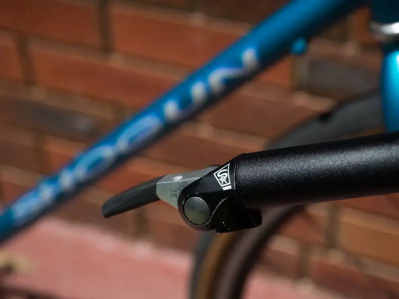

I'm somewhat locked into 9-speed for now, owing ot an index-only* bar end shifter I kept from the Marin project. With a friction shifter, one is less limited by compatibility / cable pull and could potentially use a 10+speed clutched rear derailleur. For now however, I'll be using the plucky XT derailleur with an 11-40T cassette as part of a 1x9 system.
*SunRace SLR96; it does the job but I'd recommend Shimano / Microshift (or anything that has a friction mode) over this.

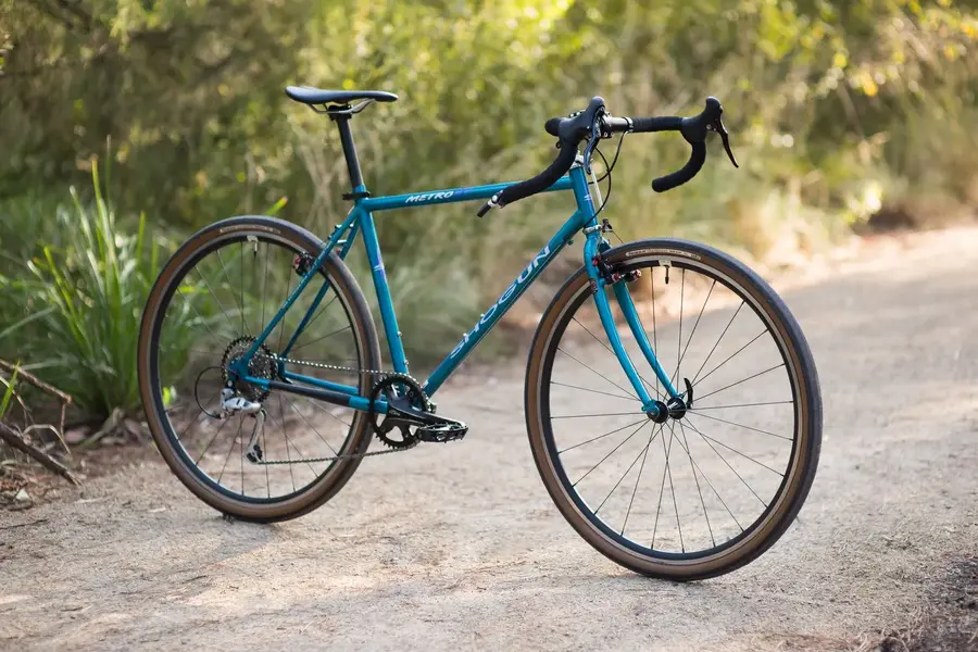

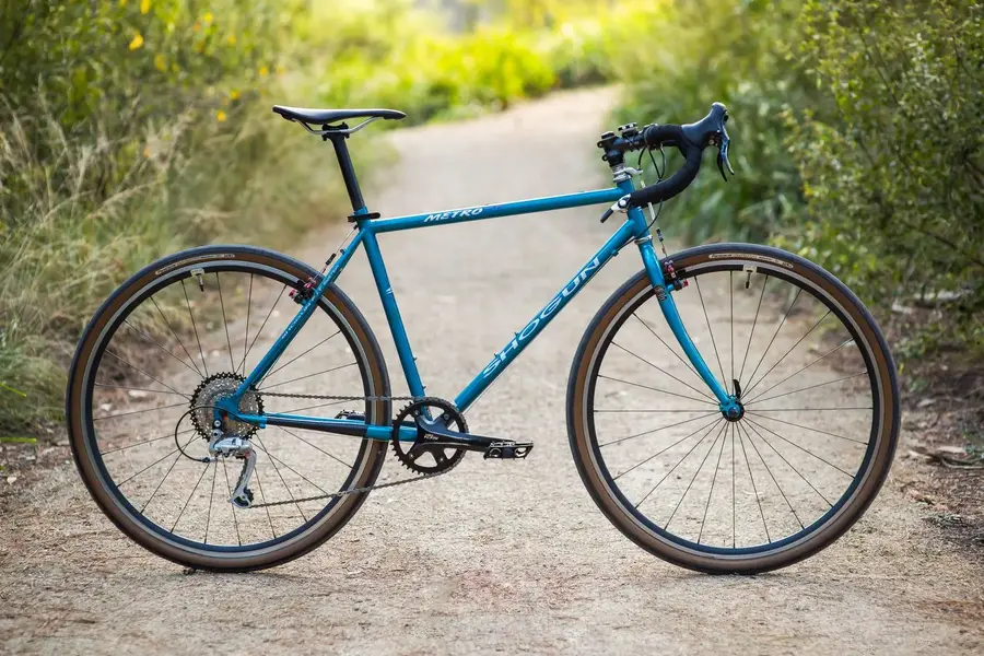

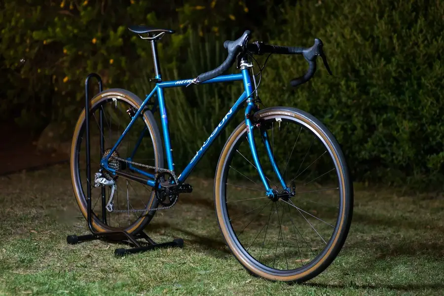

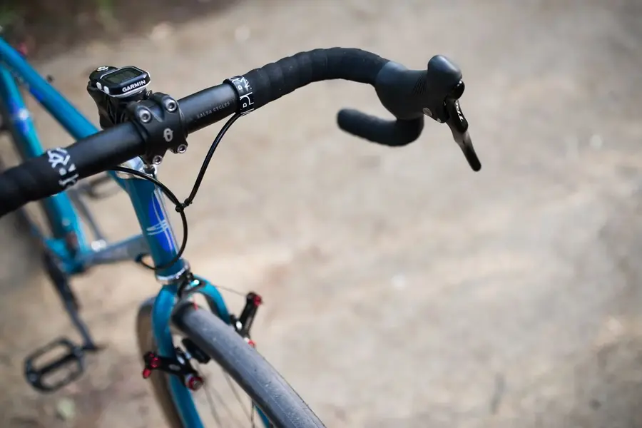

Also, it's pretty much done! I am pretty stoked with how it's all come together.
I shall get some proper snaps in daylight (after I've taken it for a spin of course!)
Spec:
Shogun Metro AT
4130 Templite Cro-mo
Wheels:
Giant PR-2. Another save from the bin. The braking surface is in very good condition but a little research reveals they're not at all popular with Giant (TCR?) owners so we'll see how they go. Tyres are Panaracer Gravelking 700x38. I've got some 40c knobbies arriving soon so these are place holders for the moment. The Shogun doesn't quite have the tyre clearance of the Marin so I'm sticking with a conservative 40c for the moment.

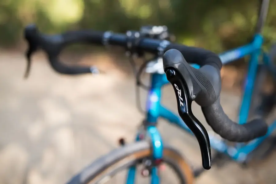

Braking:
Avid Shorty Ultimate w/ Swiss Stop pads
TRP RRL brake levers
Drive:
Shimano 105 FC-5800 w/40T Narrow-Wide chainring
11-40T cassette w/ Shimano HG53 chain
SunRace SLR96 Bar end shifter
Shimano Deore RD-M761 + Road Link
DMR V8 Classic Pedals
Finishing:
Quill > threadless adaptor, courtesy of the PRC
Cosine 90mm Stem
Salsa Cowchipper Flared Drop Bars 440mm w/ Shimano Pro cork-ribbon bar tape
Saddle: Fabric Scoop Shallow
Seatpost: BBB Skyscraper ⌀26.8 (very fortunate to have found this as it's a two bolt configuration that will suit my saddle bag support).
Thanks for reading!
