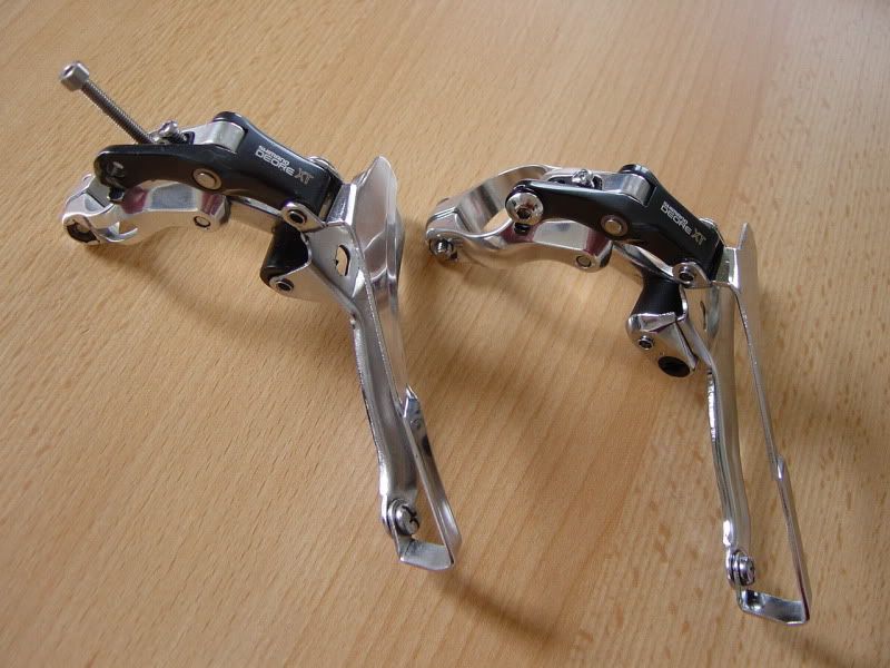

I have a 735 without the adjuster :D
WD :D
WD :D
And a nicely machined clamp too!

Just to add some clarity / confusion (delete as appropriate :lol:) :
Both are marked as 735's and both are the metalic black (rather than the gloss black of the 732). Not sure if they are O's or 0's but both characters look identical and the codes are :
0F - no adjuster
0L - with adjuster
The one with the adjuster has a slightly different shaped back cage - Other than that they are identical - castings marks and everything else :D
WD :D
not read all this post yet
but that looks like 2 different mechs
not any shared parts that i can see
That will be the confusion option then :lol:
Defo the same dude, the camera angle / perspective / adjustment angle may not do the pic any favours but comparing the parts in front of you - identical other than differences listed above :D
WD :D
That is quite a large setting screw you've got in there. Is that to set the derailleur while riding? :D
