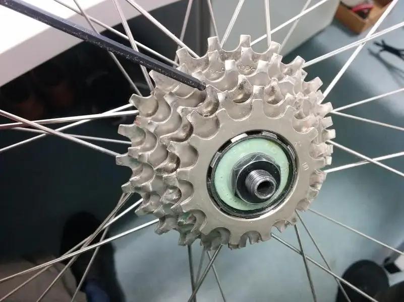

Is the 4th sprocket correct? in my cassette that I'm pointing at. It has
different tooth shape to the rest. Just wondered if this was done for a technical reason is
it a rouge sprocket.

with uniglide cogs you can ride them flipped around to double the wear/life ( except the small threaded one )
Bearing in mind the follow up post it does look as if that sprocket is well worn and then reversed. As the rest are not it suggests that the cassette is a bitsa. Of course there could well be another reason
Your sprocket isn't worn! The angled sprocket is a so called 'super shift' sprocket, seems you only have one fitted, have a read..

The sprocket is a rouge one. On dismantling the cassette, it was clear the plating colour was different. I have got a replacement 17T one from eBay.de.
