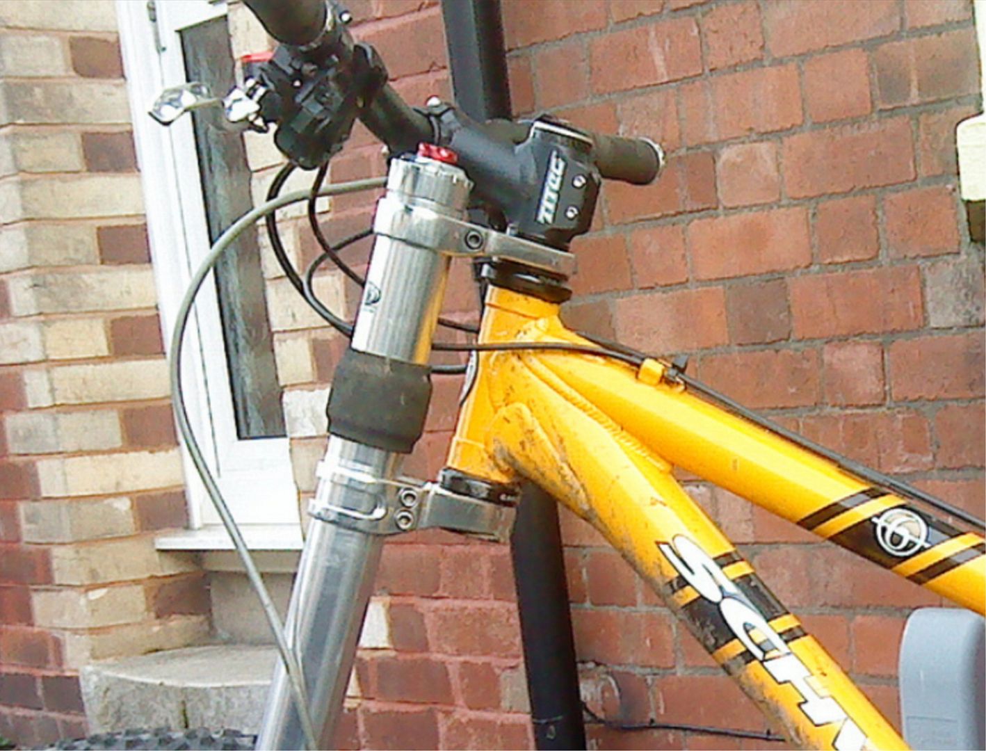

That's actually a Straight 6 with the Lefty.
You can get converters to use Lefty with 1 1/8 headtube, the 4B headtube is a bit short, but the S6 headtube is longer so works better with less spacers.

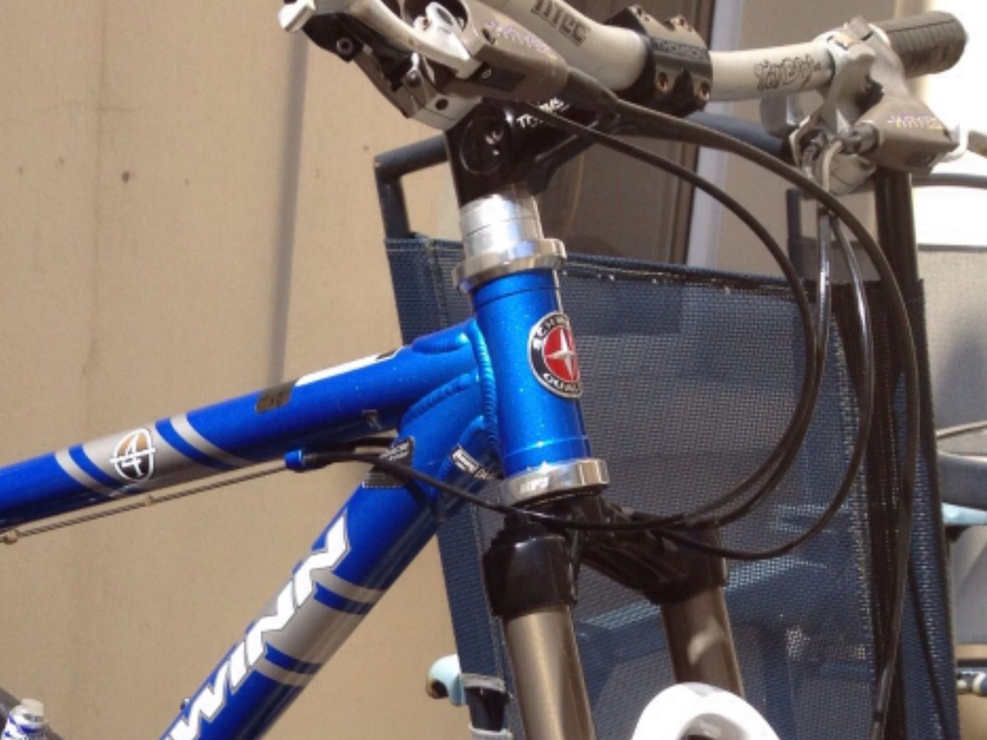

I came this close -----> <----- to buying a lefty fork today, then I noticed something right before I handed over the cash...
Your Straight 6 headtube.

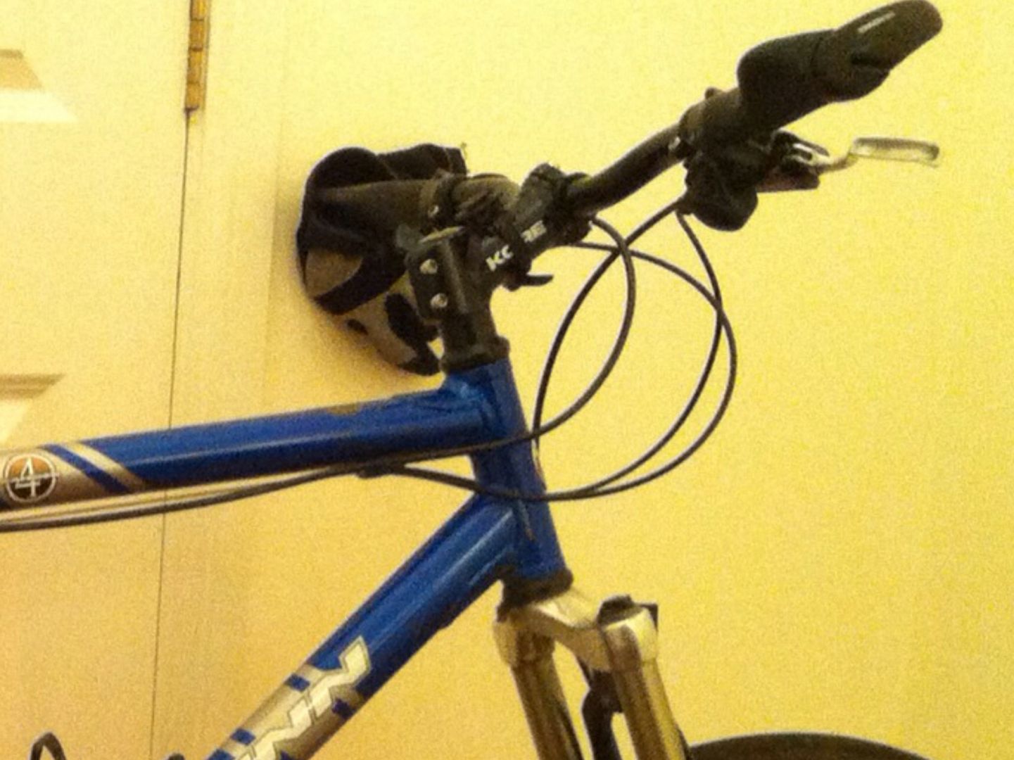

BarneyBallBags 4 Banger.
My 4 Banger...
Note the difference in the head tubes. Mine it would seem, is significantly bigger than yours...:wink:
So the S6 headtube isn't necessarily longer than the 4 Banger. More important it would seem, is the frame size.
This of course means that the lefty won't fit my frame in standard guise, and even a lefty xl might be a squeeze.
You learn something new everyday on here...
yeah I should have clarified there.
"for the same given frame size the S6 is longer"
however if you have a much larger frame then obviously will be bigger!
The longest headtube (without headset cups fitted) I've managed to get a lefty to fit with is 118mm and I then had to use a very low stack crank brothers headset.
I've been looking into this whole lefty conundrum.
The standard cannondale lefty has a distance of 137.7mm between the yokes. My large framed four banger has a naked headtube length of 140mm.
Add an average sized headset, and that gives a stack height of about 170mm, miles to big to fit a lefty on to.
Cannondale do an XL version of the Lefty that they fit to their larger frames, which is 163mm between the yokes. A low profile headset from crank brothers adds 22mm to the headtube, so at 140mm + 22mm = 162mm, I could just about squeeze an XL lefty on the bike with 1mm to spare.
A tight fit, but it is just about do-able...
