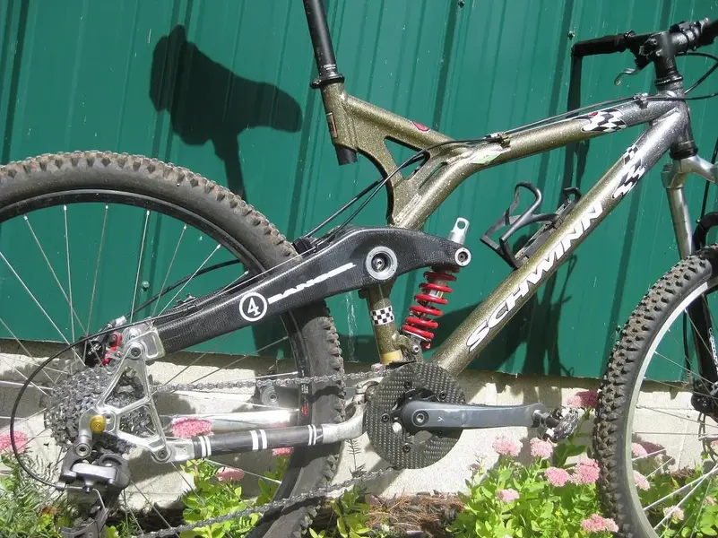

Here is my HG 4 Banger with a 2" stroke shock. Problem is there is not much room for adjustment. Wish I could find a Fox trunnion... Someday I might try the stock Sid air shock, have always used a coil.
For me this is frame #3, had a couple regular frames that cracked and ended up buying a spare HG front end in case this one dies.

I used a 22mm to IS adaptor then a front caliper on the rear so I can still run a 160mm rotor. Then used the rear caliper on the front so no adaptor needed for a 180mm rotor.

Early dropouts with 22mm frame mount. You can just barely see in the pic above the red adaptor that goes from 22mm to IS, but it forces you to use a bigger rotor. To get around that I used a front caliper on the back.
