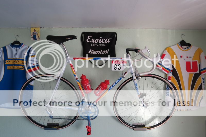

Couple of pictures taken outside
And one of it in its new home, well until I have the time and weather to use it lightly.
