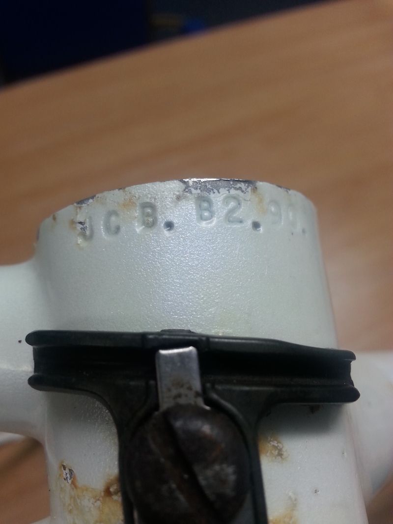

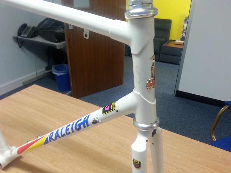

It said it was a Raleigh 753 Dyna-Tech in the Castorama colours and that it had a SB frame number. And it was £95. I straight away thought whats the catch and there in the description it was. The frame was cracked by the front braze on mech hanger. It also said it had a 2nd frame number which read OCB.82.90. I took a punt and made an offer.
Once it turned up we paint striped the area that had a tiny tiny crack in the paint and result ..... it was only paint deep.
As for the 2nd frame number it actually read JCB.B2.90 and from what we can see that makes it the 2nd frame that was built in 1990 for Jean-Claude Bagot.

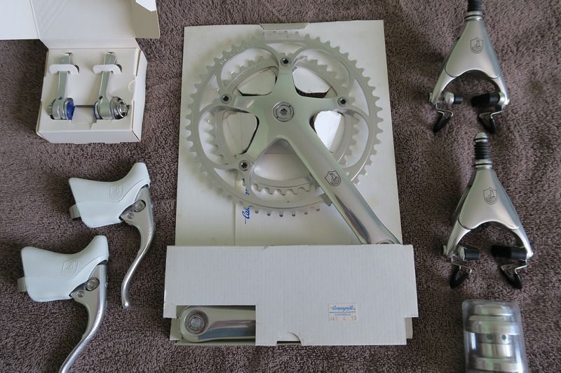

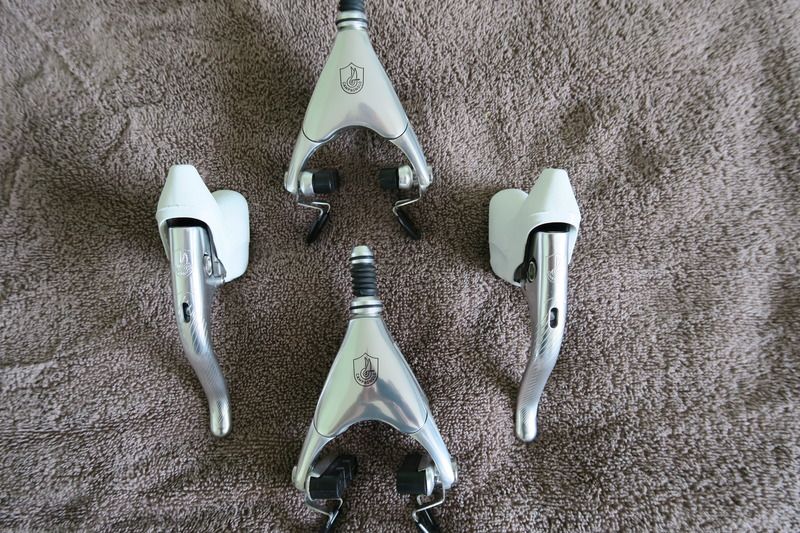

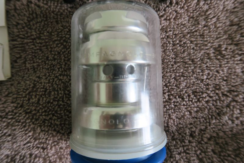

I've started to collect a few bits already starting with what I deemed as the most expensive parts.
So far I've got the Brakes, Brake levers, Headset, Chainset, and a pair of Wolber TX 19 rims.

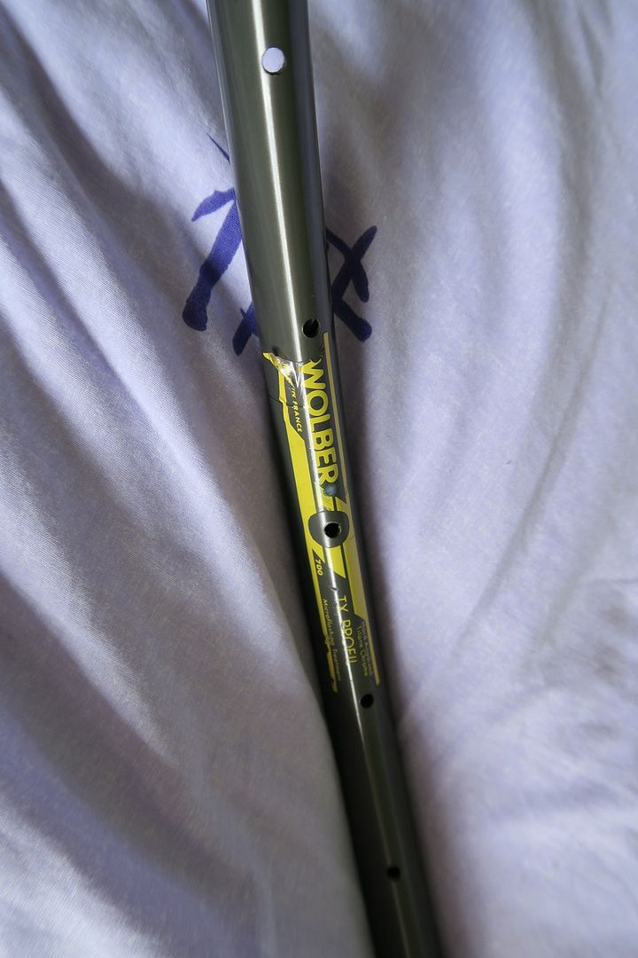

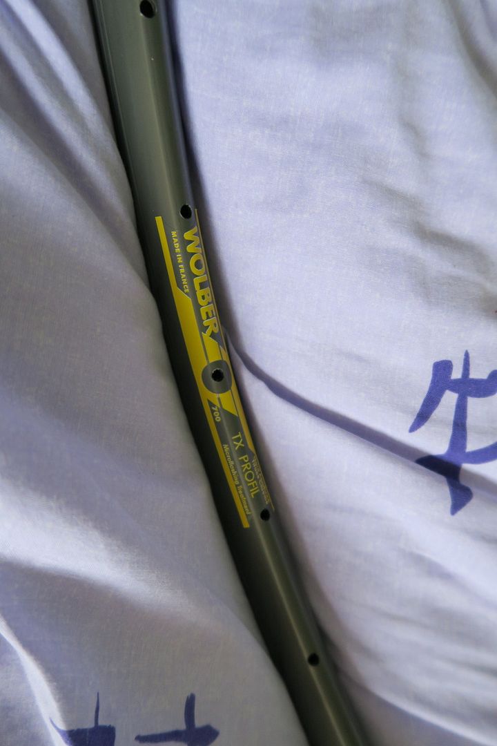

As for the wheel rims I knew it would a tough one, but again a random search on the bay threw them up in france cheep. Decals on them were shot so working on having new ones made and then looking to get the rims re-anodized
Old decal
New one's Just needs a little tweek

Thanks, I've got a pair on nos hi-lites but as 20's rather than 23's. The rim decals in the picture are with me but just having them changed a little as there should be a clear cap after the "R" in wolber.
Will let you know once the new ones turn up.

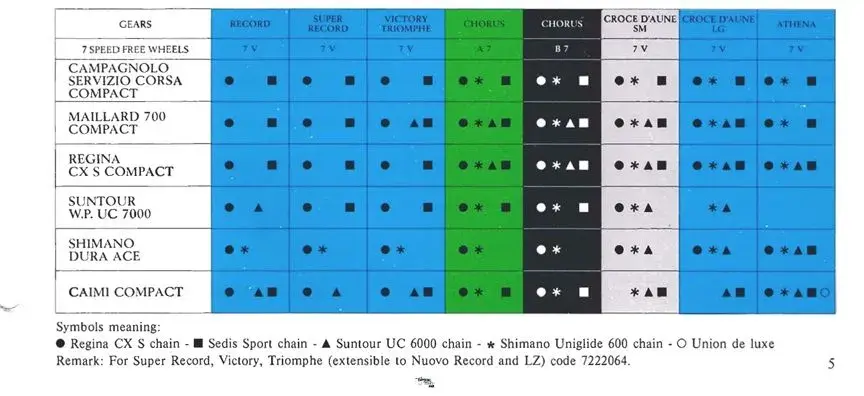

Going to be using 7spd, I have the 7 spd syncro levers with a blue insert to run with the Gen 2 C Record rear mech that should be on its way to me.
I've got the updated wolber decals on their way, got a couple extra so if your happy with them once you see the pics I send you they will be £1.50 each plus a stamp.

This will be of help trying to get the Syncro levers to work.
You need to get the right chain/freewheel combo correct for the rear gear used & coloured insert in the lever.

Thanks for the above Stringfellow, still working on getting the rim decals just right and have also picked up a pair for a mate which have the original white letters on them so will be having those done also if you wanted some.

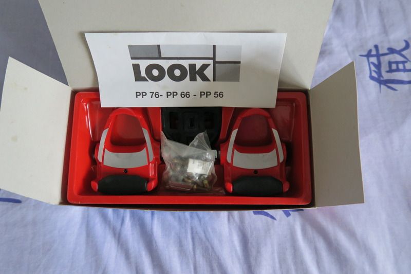

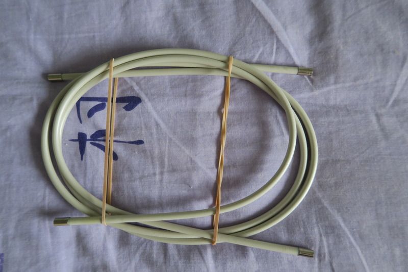

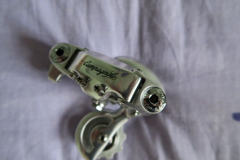

In the mean time a few more bits have arrived, Rear Mech, Brake cables, Look pedals (I know the team bikes used time but I have used look since for ever and the cleats are much easier to find and use).
And thanks to Penfold I now have a matching pair of bottles.
Next up date might be a while as I'm all spent out now and need to get some cash in for more bits :)

Just been having a pay about with the new decals I had mad for the frame
These haven't been put on that well as I just wanted to see if the sizing worked (and the frame still needs painting). Looking at the pics and frame thou I have asked to have the named one re-done with a smaller gap between the "e" and the "B"
