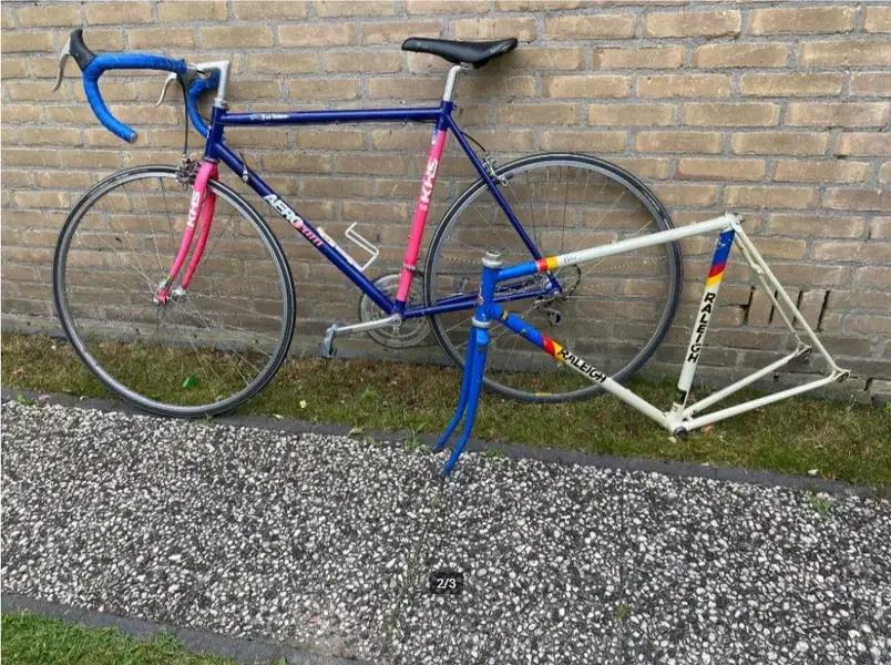

Last september, I caved when I saw an add selling this KHS bike (which I had never heard of) and a Raleigh Corsa 501 frame.
The - somewhat elderly - owner bought both bikes new 25-30 years ago, and after overpaying a bit, I took home the steel set. :p
My initial plan was to build up the Raleigh as a 650b wide tire steed, as I lace my own wheels, and the frame has plenty of clearance for 35x700c tires.

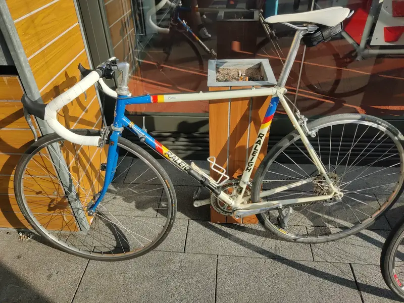

But when I started checking all the parts on the KHS, I came to the conclusion that that bike was built up using the Raleigh's original shimano parts from 1985. Even the bottlecage seems original to the Raleigh.

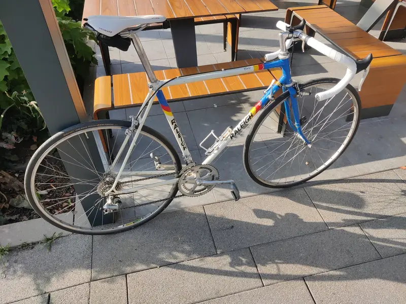

So after truing the wheels, greasing the hubs, bottom bracket, and headset, I built up the Raleigh and added some new brake pads, 23mm Conti 4season tires, a new 7 speed cassette, and white bar tape.
I rode that bike some 200km for fun, but downtube shifting will never be a joy for me.

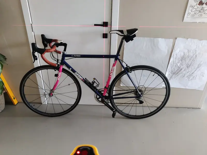

First iteration, with 100mm stem and brown bar tape. The initial plan was to use a brown saddle as well.

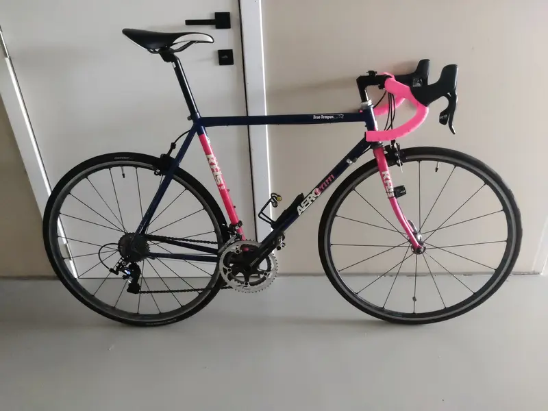

New handlebar with 80mm stem, pink bar tape, cables shortened.
It was a real pain getting the stem over the bar, so I just bought another handlebar for the new stem. The 100mm set will be reused on another build in the MTB section.;) I really like the black stem/bar/seatpost look.

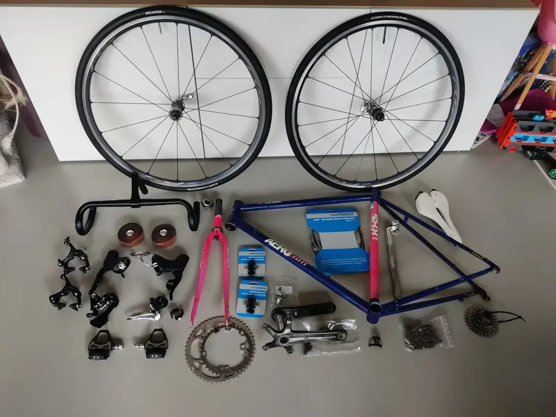

This was a budget build with a mix of used and new parts, often from Ali Express. I wanted to try a new Chinese group :oops: vs a used shimano/campy
I documented everything on video for Youtube. This isn't my first build, and will definitely not be my last.:cool: Got tons of photo's too if anyone's interested.
Frame: KHS Aero Team 54cm
Fork: KHS Aero Team
Front Derailleur: Ltwoo 2x
Rear Derailleur: Ltwoo 9x
Number of Gears: 22
Shifters: Ltwoo R9
Bracket: Campagnolo Ultra Torque
Crank: Campagnolo Ultra Torque
Chainrings: Campagnolo 39/52
Cassette: Shimano CS-R7000 11-28
Chain: Shimano Ultegra HG-601
Pedals: Ultegra SPD-sl / Crankbrothers Eggbeater 3 (cold weather)
Brakes: Raceworks/ Ultegra pads
Handlebars: Ali express 38cm
Stem: Ali express 1" 80mm
Headset: Shimano 600
Bar tape: Ali express brown => pink
Wheelset: Shimano WH-RS500 (ultegra level)
Front Tire: Continental GP5000 S TR 25mm
Rear Tire: Continental GP5000 28mm
Saddle: Fizik Aliante Gamma
Seatpost: ZOOM black 26.8mm
Weight: <10 kg

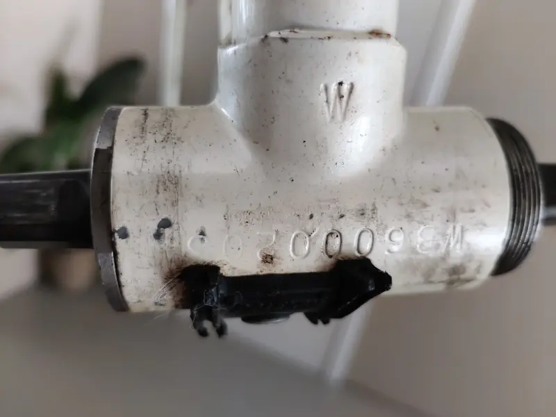

Some Raleigh pictures.
frame: WB6000203
